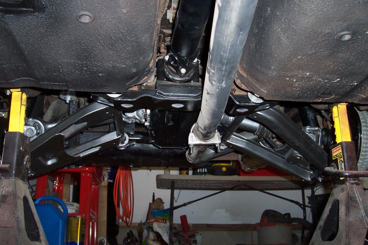

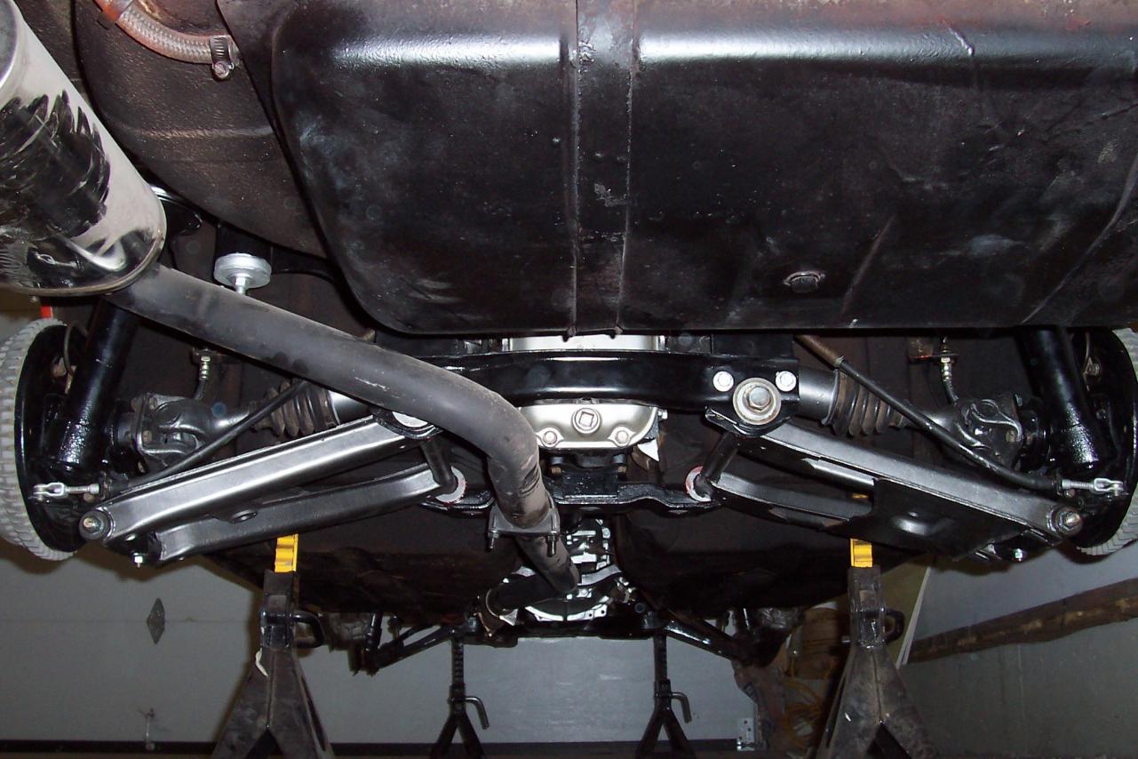

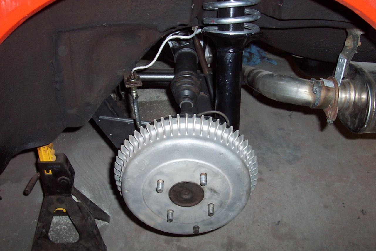

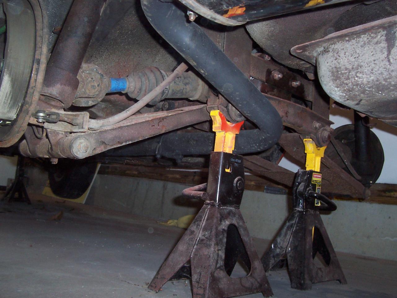

January 12, 200916 yr Author comment_271001 I finished the 5-speed/4.11 swap this weekend. I attached a few pics. I decided to introduce a little color into the suspension, so I painted the half-shafts and control arms a gun metal gray, everything else is black. I held off on the rear sway bar for now, I'm gonna see how I like the ride with the new struts and decide if I need the bar. Most of my driving is in a straight line anyway. :devious: I don't care how many times you've laid under a car while its up on jack stands, but that is an un-friggin-comfortable position to be in. I'm glad to be done underneath the car for the Winter. Nothing scarier than shaking the tranny around to get the shaft in, while the car is held up on four small metal stands. I've been working on cars my whole life, and I still hate being under there. The work itself went really easy, no major issues. The speedo issue was easily resolved. I cut a new notch on the pinion sleeve exactly 180 degrees opposite of the original (factory) groove. The pinion slid right in and engaged the tranny gear, no problem. The half-shafts, driveshaft, mounts and all of the other original components from the original 4-speed/old differential worked fine without any mod's. at all. Now I just need the freaking snow and salt off the roads, should be good to go around May.....:mad: Link to comment https://www.classiczcars.com/forums/topic/30355-5-speed-install/#findComment-271001 Share on other sites More sharing options...
