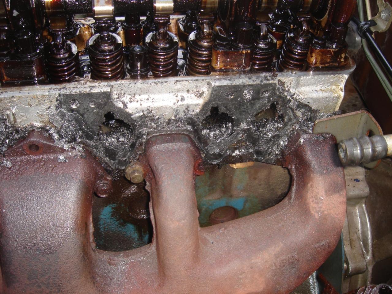

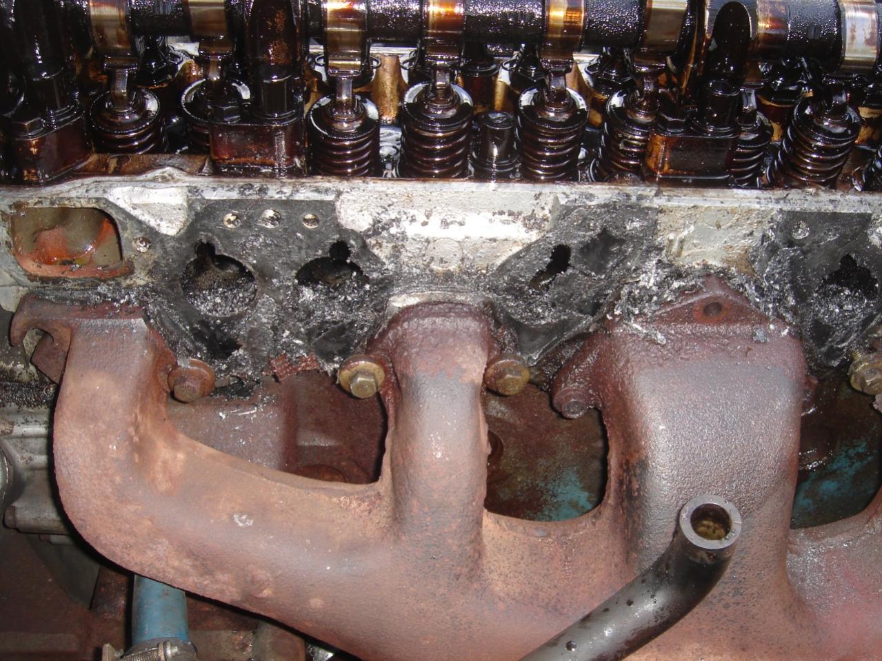

December 31, 200816 yr comment_269958 You can actually get to the lower 6 bolts needed to remove the intake manifold without removing the heat shield. I tried to remove the shield thinking it would make life easier (and it would have) but I couldn't get them all off (rusted, then rounded). I tried the dremel solution, but couldn't get it to where it needed to be-very hard to do without seeing what you are doing, and I wasn't going to use my finger as a guide... You will bust a couple knuckles, you will curse up a storm, but you will get them off. Knowing where they are helps quite a bit, and I was very unhappy with my FSM for not even mentioning that the lower 6 had to come off/be loosened in order to get the intake off. Attached are photos showing where the bolts are/should be. Hopefully your intake manifold won't be as hard to remove as mine was (I needed to utilize a hydrolic jack to break mine loose from the head once the bolts were off) Link to comment https://www.classiczcars.com/forums/topic/30361-help-with-exhaust-manifold-on-83-280zx/#findComment-269958 Share on other sites More sharing options...
