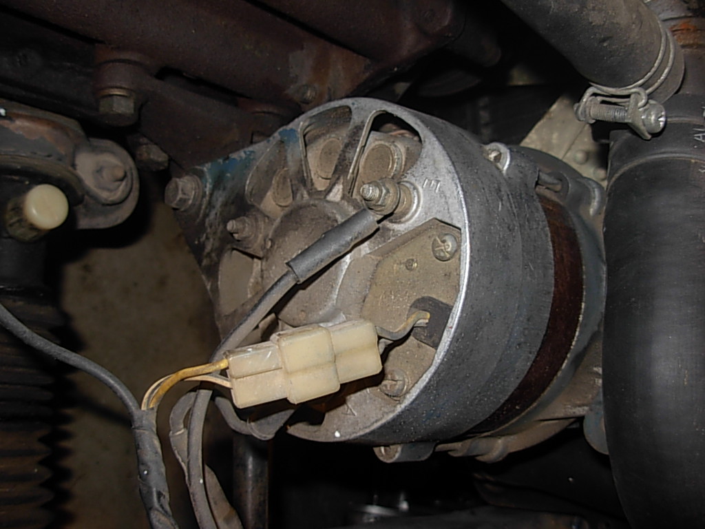

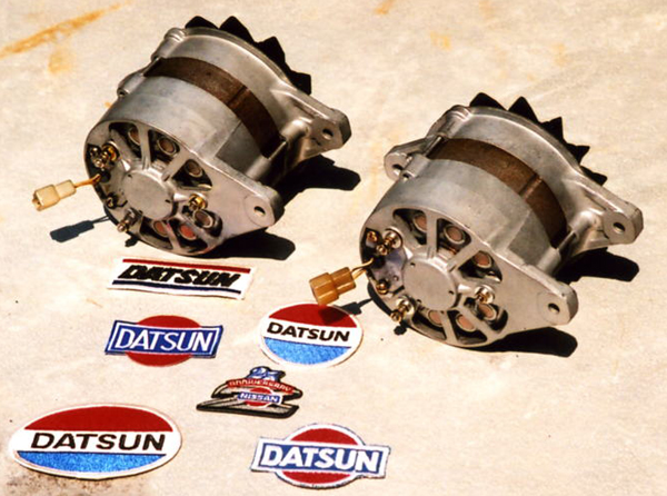

Does the alternator you pictured have a part number engraved into the housing? There were actually two grapefruit alternators, one for the L20 and one for the L24 with different part numbers. I think that #210 could be a gold mine of originality info. Standby for being pestered by me.
In your picture, you show that little oil press. sending unit wiring minder which is bolted to front engine mount. Would you, or anyone, happen to have an extra one of these little minder hooks available for sale?
Dan, it does have something engraved on the top. I tried to clean it off quickly, but I probably need to take it off to see it better. If you look at the first picture Kats attached in the post in the other thread, it looks like there is a Hitachi symbol and some writting, maybe a part number. Kats says the Hitachi part is #LT145-35. The parts catalog shows the Nissan part #23100-A4800 for the early 40A alternator.
As for the oil pressure sending unit wiring minder, I checked my low mileage 72 and it also has it, so apparently it is not just an early item. It is missing from #32, however. Unfortunately, I don't think I have any spares.

Thanks, Mike. That is my point of confusion. I have two alternators with the following engraved in the housing.
# 1. LT140-53 104 (Not LT145-35 as Kats references)
23100 A4800
# 2. LT145-35B105
23100-E5200
But my FSM engine book on page EE-20 says the Hitachi LT145-35 is for an
L24 engine with an output of 12V-45A, and the Hitchi LT 140-53 is for an L20A engine with an output of 12V-40A.
Both of these grapefruit alternators appear to be identical in appearance, otherwise. Our parts CD shows the original alternator is 23100 A4800 with an output of 12V-40A.
When the weather warms and you get into cleaning under the hood, you may hold the definitive answer as to what is correct.
Thanks, Mike.
Dan

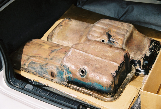

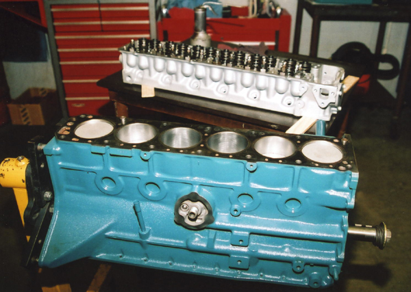

I concur, Dan. My Nov. 1969 engine manual lists the same information however the parts catalog says 40amp. I don't know why. I'll have to dig mine out and have a look at the stampings on the castings. In the mean time, a couple of pictures to reference the color blue and the overspray on the oil pan. The oil pan in front is correct for early engines as it has the reinforced plate on the side. Service bulletin TS70-28 from August 21, 1970 shows an eight counterweight crankshaft replacing the six counterweight shaft. As I have understood, this was due to vibrations which I believe caused the oil pan to crack. Thus engine serial #'s prior to L24-3607 would have the reinforced pan. Notice the paint "overspray".
That answers my next question "how do you tell the difference."
I guess the easiest way is the ribs. The PO painted the whole oil pan blue. Guess he took over spray to the extreme.
Thanks

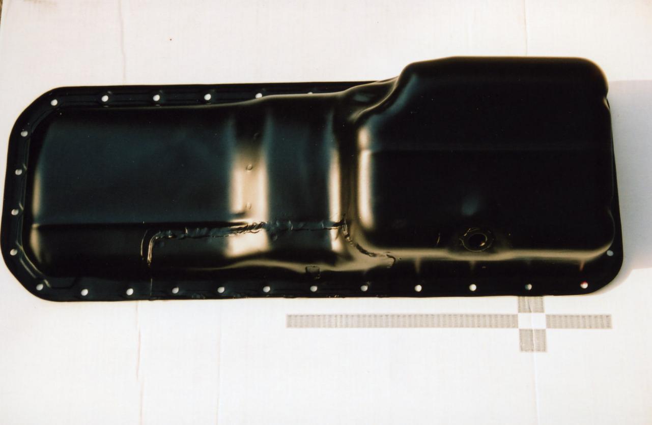

The oil pan from 26th restored. The plate on the side was actually braised to the pan. Now a question I have. Was the alternator pulley painted or plated? I know the fan blades are plated, but the engine service manual, even though black and white photographs, shows what appears to be a painted pulley.

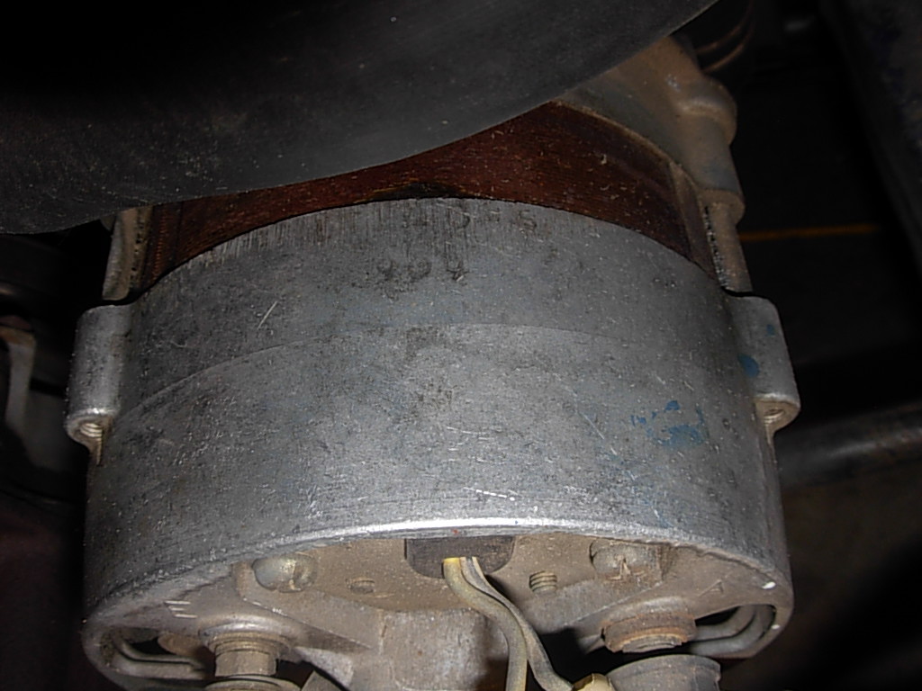

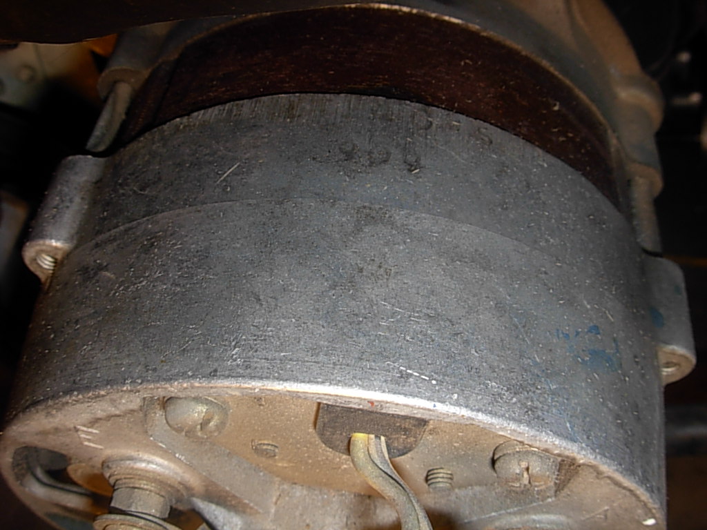

Here is the alternator on #32 (its a little cleaner) ;). I tried lighting it and taking pictures from several different angles and these where the best I could do. I think it has something that ends in 45 on the top and maybe 904 below that? I don't know, I look at this stuff too long and its like looking at inkblots, I could pretty much turn it into anything.
-Mike
Thanks, Mike. I won't be home for a few days, but when I return I will try to upload a couple of pics of my alternators with the inscriptions for comparison.
The engraved parts numbers may be on a part of the housing closer to the mounting pin.
Dan
