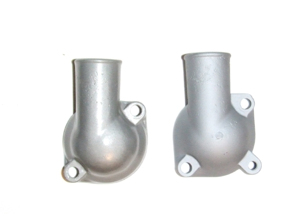

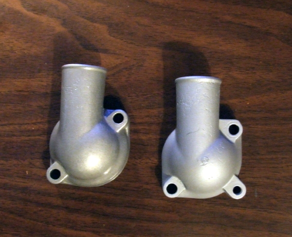

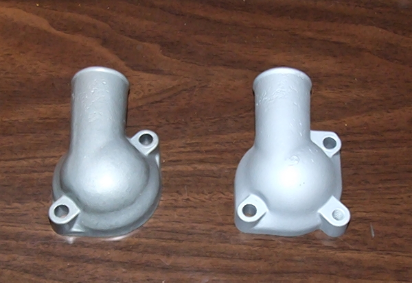

January 11, 200916 yr comment_270859 Johnny'O - Nice work. Carl recommended a "dull aluminum" paint. I've experimented with that stuff recently, and can say IMO it gives a better final look than a clear coat. Clear coat is nice, but it darkens the media blasted surface (kind of looks 'wet', a shade or two darker). For looks, my first preference on these aluminum parts is just media blasted with no finish coat. But, the parts are prone to staining/discoloring when they encounter various fluids, and as Carl mentioned, oxidation. Second is hi-temp dull aluminum. Honestly, it makes them look great, and gives them a protective coating. Third, and still acceptable IMO, is a hi-temp clear coat. From what I see in your picture, you likely used a glossy aluminum. For my taste, and I think yours based on your comment, it's just too shiny. Give the dull stuff a try and I think you'll be quite pleased. I am using a product off the shelf at NAPA - "VHT" (Very High Temperature) Header Paint - Flat Aluminum/Aluminum Matte - Product # SP-117. Give it a try. I'm confident you will be pleased. Attached are several pictures of two parts; both glass beaded, one clear coated, the other (on the right) painted with the VHT. There are lots of other 'before & after' pictures in my gallery as well. I'm having a real blast with my blaster.... addicting, aren't they?? Link to comment https://www.classiczcars.com/forums/topic/30365-series-1-engine-paint-plan-details-please/?&page=4#findComment-270859 Share on other sites More sharing options...
January 11, 200916 yr Author comment_270874 John,I agree. The clear gives it a wet look at least 1 shade darker but I did prefer that look over the standard Plasti-Kote Aluminum paint I found locally. I use VHT clear satin from napa, I will run by there today and pick up VHT Flat Aluminum and see how it looks.Thanks,John Link to comment https://www.classiczcars.com/forums/topic/30365-series-1-engine-paint-plan-details-please/?&page=4#findComment-270874 Share on other sites More sharing options...
