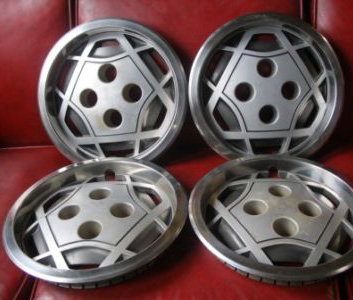

February 26, 200916 yr comment_275531 zbane said: So far as I know, all ZX (s130) models came with alloys (with the exception of the spare, of course) so hubcaps will not be usable.No, 14x5.5 steel wheels were standard on the base model 280ZX from '79-81. (14x6 Iron Crosses were optional.) Not sure about the '82 and '83 models. The '79-81 with steel rims came with these hubcaps. Link to comment https://www.classiczcars.com/forums/topic/30430-stock-rims/#findComment-275531 Share on other sites More sharing options...
February 26, 200916 yr comment_275533 Arne said: No, 14x5.5 steel wheels were standard on the base model 280ZX from '79-81. (14x6 Iron Crosses were optional.) Not sure about the '82 and '83 models. The '79-81 with steel rims came with these hubcaps.Something new every day, thanks for that! I've seen those caps fitted on a zx, but thought they were alloys-I did see them from a distance. Yeah clarification! Link to comment https://www.classiczcars.com/forums/topic/30430-stock-rims/#findComment-275533 Share on other sites More sharing options...
