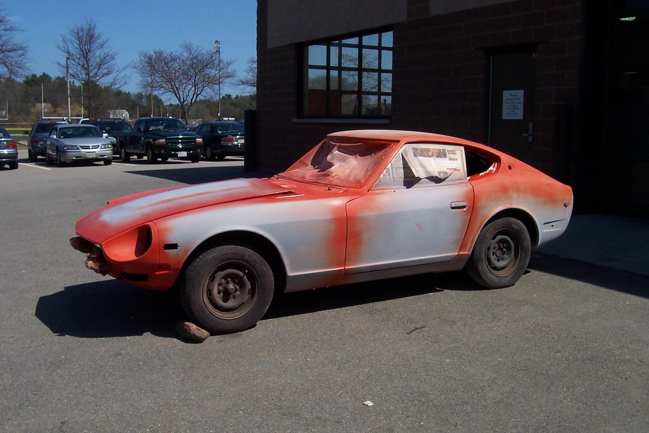

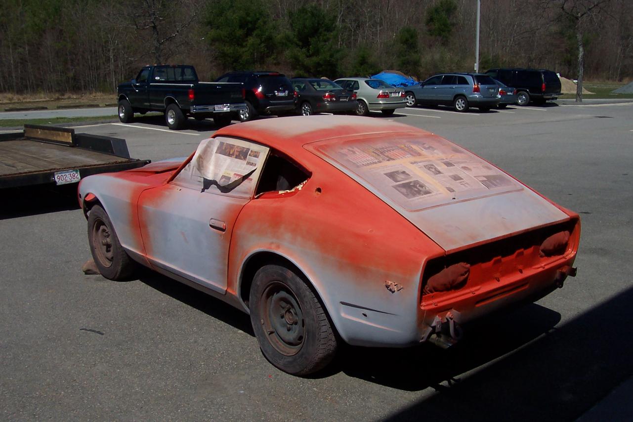

My dad (Diseazd) Has been looking for a passenger side dogleg for his 71 240z for quite sometime. Our body guy has Tabco pieces but he doesn't like them. He is a perfectionist and looking for original Nissan piece.
He is even less enthusiastic about Wolf steel/alfa parts so......
If anyone has or knows where we can find a passenger RUST FREE dogleg, please let us know. Even if it's on a car and needs to be cut out. We will pay for labor depending on the cost of course. For anyone who is not sure what the dog leg is, it's the outer metal b/t the rear end of the rocker panel (below the door) and the front of the rear wheel arch.
Thanks in advance,
Brandon

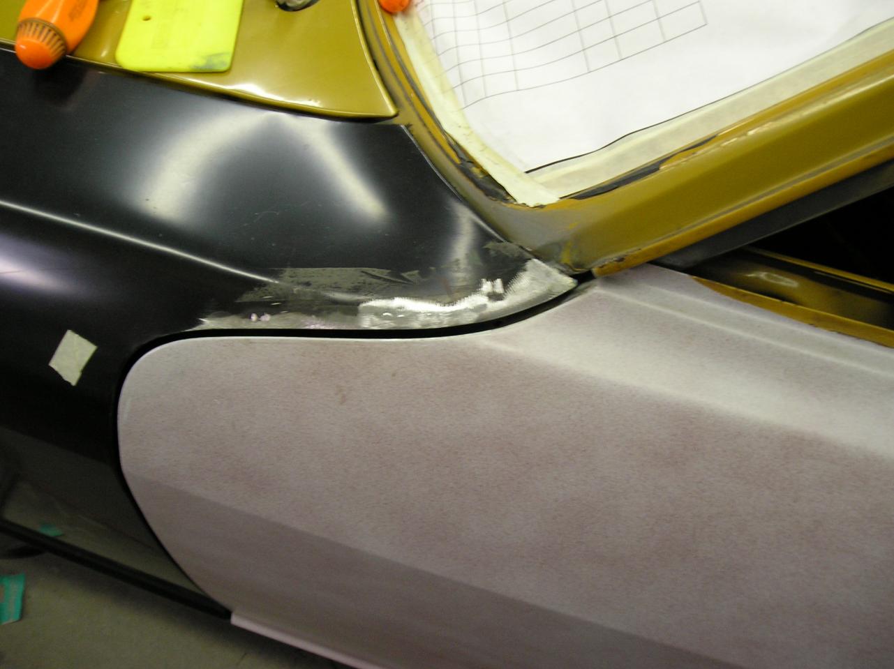

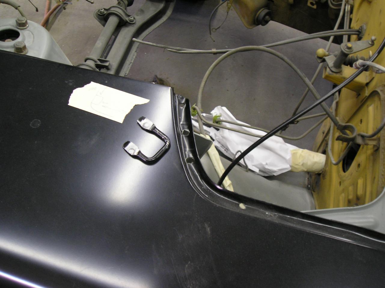

Good work no doubt. Our body guy is an absolute perfectionist. It has to be OEM or better :) He refuses to cut any corners. Here are a few detail shots. Check out how he drilled out the welds on the master cylinder access door latch. I assume he is moving it slightly so it's perfect. The body gaps are better than factory now. This guy is truly an artist. Unfortunately for my dad, I am sure the price tag will reflect the guy's skills :)
Edited by five&dime
five&dime,
Those thumnail could be my 72 240Z.... I've been focused on the tip of the fender nearest to the rear view mirrors..... I'm also moving the passenger side inspection cover latch bar... My front fenders are Tabco via Black Dragon...
