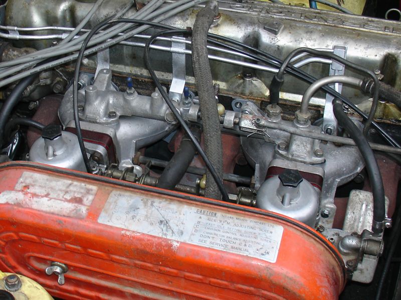

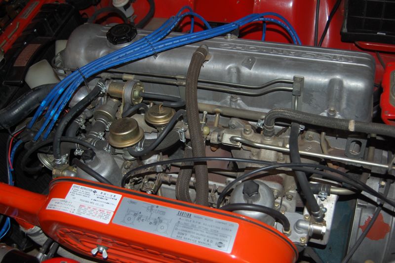

January 18, 200916 yr comment_271393 Yeah, it can all go. All you need is the PCV (like Gary mentioned), and the big vacuum hose for the brake booster. You'll also need a vacuum hose for the advance unit on the distributor, but that should come off the front carb, not the manifold. These pictures are not a totally fair comparison, the de-smogged car was my ratty yellow car (since parted), and the smog-equipped is my much nicer red car. With smog -- Without smog. Note that this picture was with automatic transmission and so it has an additional hose at the rear that you won't need for a manual transmission. Link to comment https://www.classiczcars.com/forums/topic/30536-stock-exhaust-to-header/#findComment-271393 Share on other sites More sharing options...
