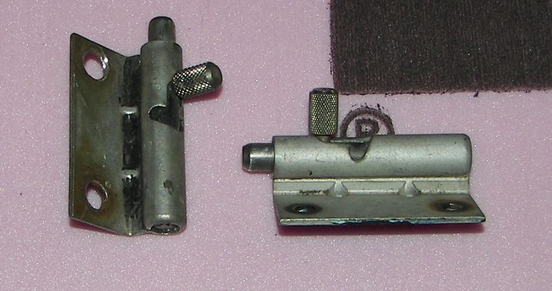

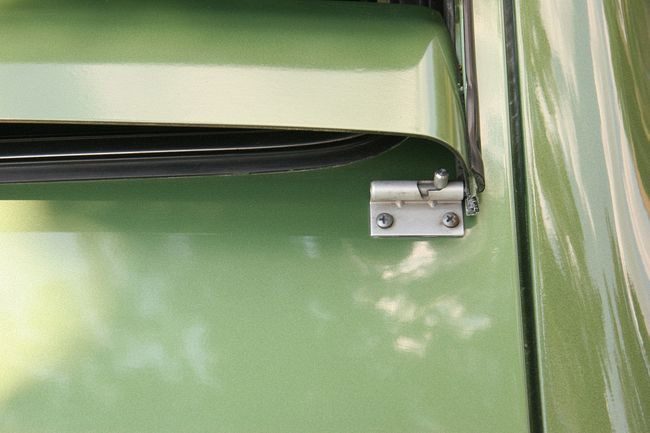

The rear louvers should have a set of deadbolt slide locks that either mount with sheet metal screws to the hatch lid, or if they are a later version, to a fitted piece of black anodized aluminum sheet that tucks under the lower window seal in the two lower corners.
I have a set of the deadbolts, that I will hunt and post a picture of for you.

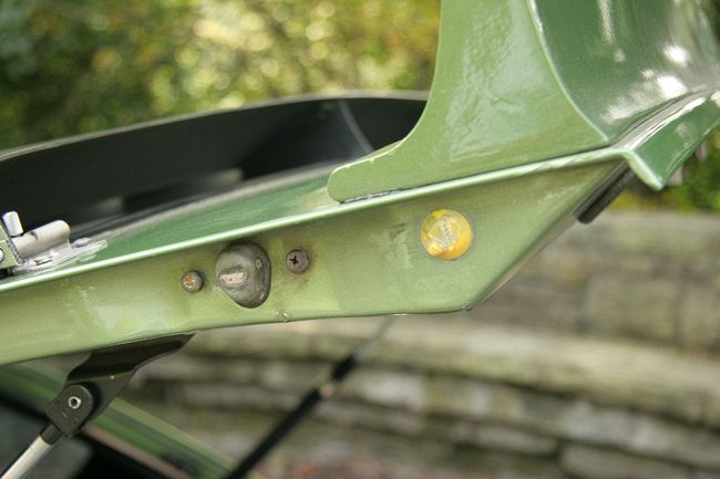

Have a look at the lower corners of the hatch louvers, there should be one 1/4" hole on each side.
Will
Edited by hls30.com
Well thank you for the pictures, Will! The louvers do indeed have the holes at the bottom. Now would those happen to be extra parts that you might be willing to part with? I would surely buy them from you if so!

your louvers look bigger than the window-the sets I have are all the same size as the Weatherstrip-meaning they don't cover hardly any of the hatch sheetmetal-only at the top(for the hinges. I don't have them and a hatch handy to illustrate, but they seem to fit the opening much closer than yours. If I put the latches to the underside of the louver, they would have to be mounted on a piece of sheet metal and it would be between the weatherstrip and the glass.
