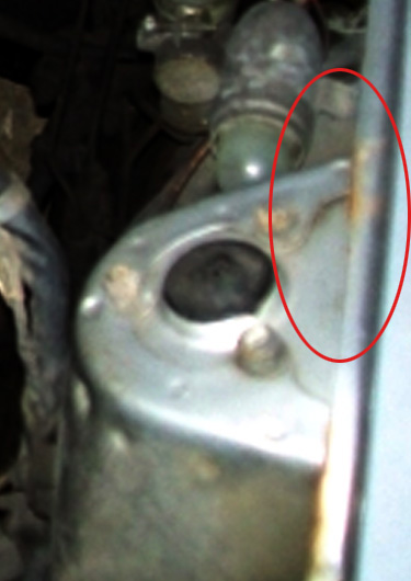

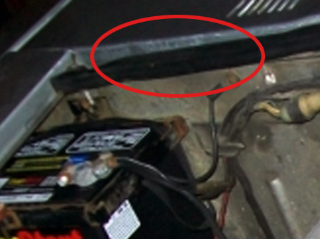

A couple of things I see, over by the battery there seems to be paint flaking along the edge (see picture). Along the fender by the strut tower I see rust on the edge of the finder (see picture). I copied the pictures and then enhanced them and cut out the areas. I would say that the engine compartment is not from a car with 33k miles and garage kept.
