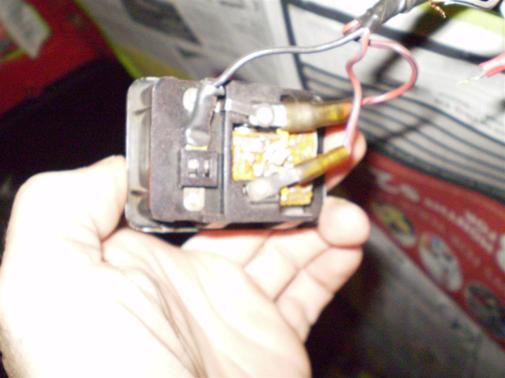

There are 2 plastic tabs on each long side of the dome light. you should be able to wiggle them lose enough to pull the assembly out. It's usually pretty easy due to the fact that it needs to come out to change the bulb out.
Ignore the circuit board where a bulb should be. And look near my palm to see the 2 tabs I was refering to,
Dave.
