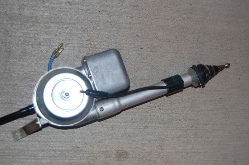

Confirmed some things as I pulled off all the interior panels in the back. The antenna and the speaker wires.
More questions though - what does the original power antenna look like? I believe what's in there is stock, but not sure as I had a second antenna come with the car (non-powered).

The original speaker (note - not plural) was a single 5 1/4" mounted on a gold cad-plated bracket in the left rear corner near the antenna.
If your antenna has two wires that are blue/red and blue/white, it's probably original.
And I don't think there was ever a Solid Mast antenna in the Z's. Took me a while just to type this.... Just got off a 2 hour skit of Guitar Hero. My 11 year old daughter was kicking my butt, so I had to show her who was boss.

Arne's on the ball,
Dave.
Arne,
Thanks - that's the unit I have. Only issue is the ball at the end was cut off - not sure why. You can tell it was cut off as the edge is crimped with a clean shear. I wonder if that's easy to replace...
Antenna is original - your pic and the wires lead me to believe so.
