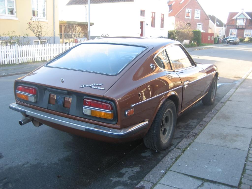

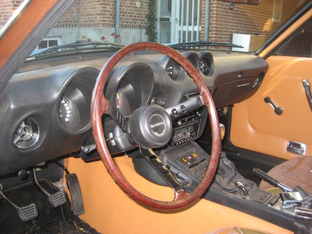

In may 2007, I bought this 1973 Datsun 240z from a guy who had imported it from California.
The floors, the rear hatch lid threshold plate and dog legs where rotten, the interior and paint where burned by the sun and all the rubber where old and hard. The dash was cracked (of course) and the AC did not work. Otherwise everything else seemed okay.
Basically what had to be done was.
1. Remove and replace the rotten metal with new.
2. New (used) dash or dash cap.
3. New rubber and weatherstrip.
4. New suspension bushing.
5. New interior.
6. Repaint.
7. Engine service.
8. Change external lights to fit Danish law.
The restoration is now almost complete and here is some before pictures.

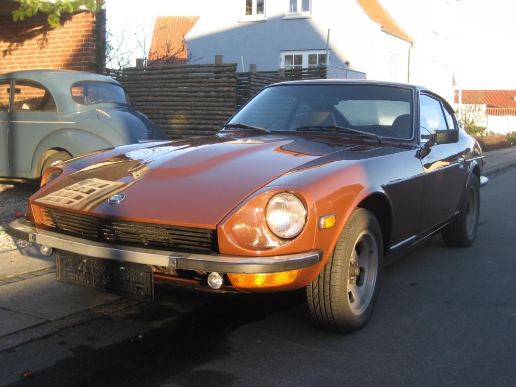

In order to make it legal in Denmark I had to retrofit some white parking lights facing forward – the side marker lights needed to be converted to turn signals (the rear ones need amber “glass”) and I had to install euro style tail lights. Because the car is more than 35 years old there is no emission requirements – so that’s easy!

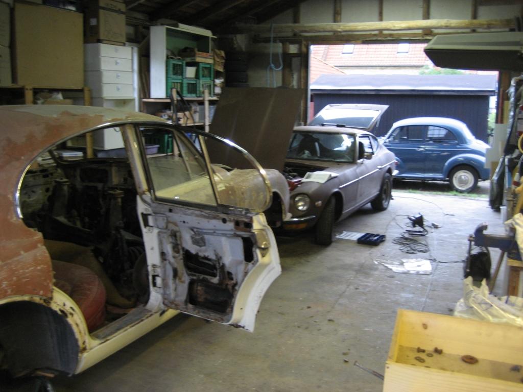

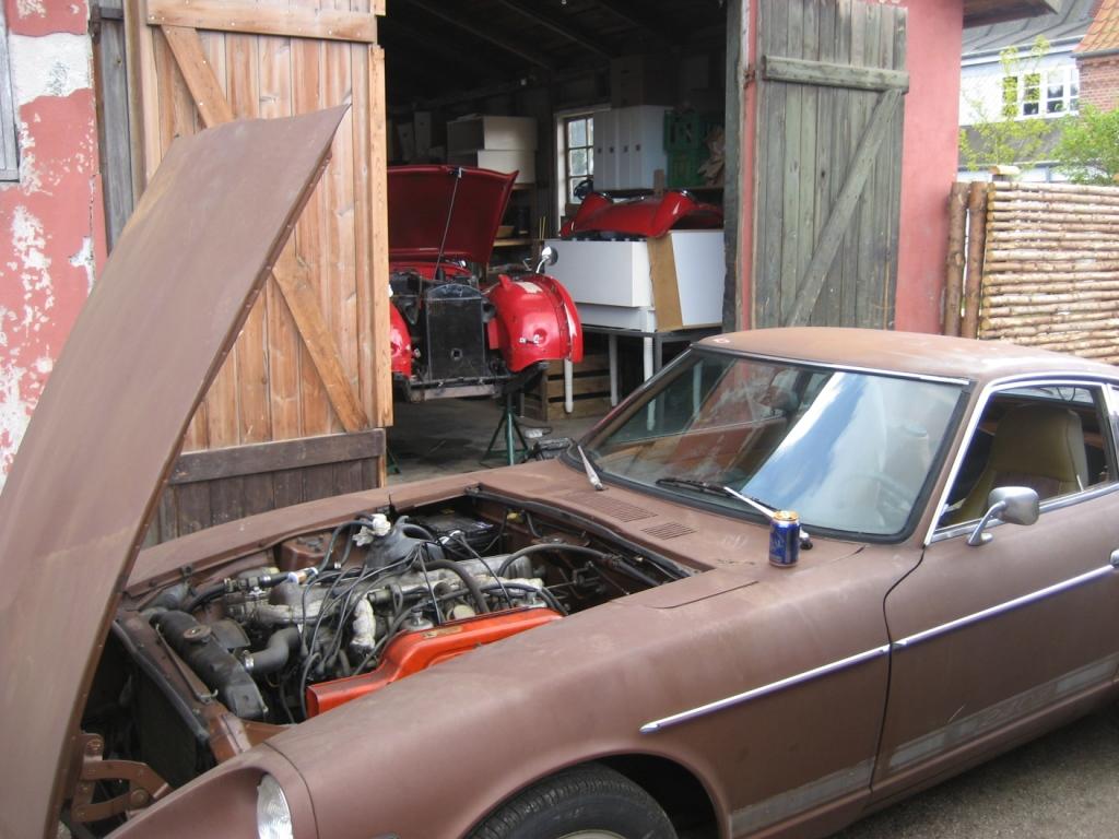

Nicely spotted – yes its my Morris. What about the red one in the first picture with the front removed – are you able to see what that is? Picture will come tomorrow:cool:
Here is a picture of my parents garage – in the foreground is my fathers Jaguar MK2 project and in the background is my Morris minor that I use every day.

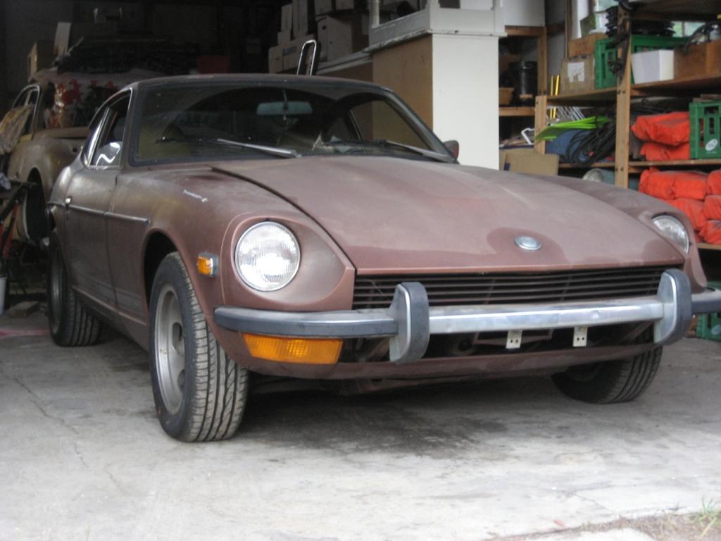

My car needs a littel work, it is rust free, but the PO burnt a piston due to driving to lean, i have had the block hot tanked, bored, surfaced, the crank and rods is re surfaced and i'm currently waiting for the pistons, bearings ect. to arrive, it is the matching block with 3 screw round tops, N36 intake, C cam and headder, 2.25 inch exhaust, a littel improvement over stock and a 5 speed tranny, i also need to get the hood re sprayed, since the paint is burned in the area just above the carbs, as soon as i got the pistons i will have the motor build, car painted and tagged, so we might end up getting them on the streets at the same time.
At my shop i have a F54 block, and spare E88 and a E30 head's, some triple Dellorto's misc cam's to have re ground ect. so when the time comes i will have a hotter motor build for it.
The euro tail lights is secured, where did you get your's, they are not that easy to get hold on, i also got a KM/H speedometer and a ralley clock, i guess that i was i bit lucky on that one.

Stephen are you able to see what that is? Picture will come tomorrow:cool:
It looks to me as a Triumph TR 2 - 3 - 3A

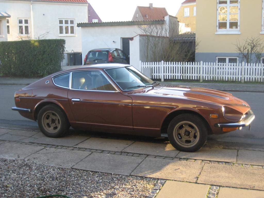

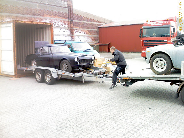

Here is a photo from us unloading the container last september
And one of the other cars we had in the shipment.
