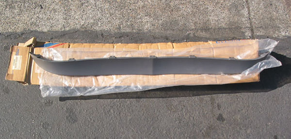

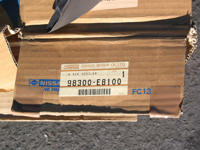

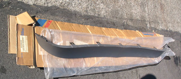

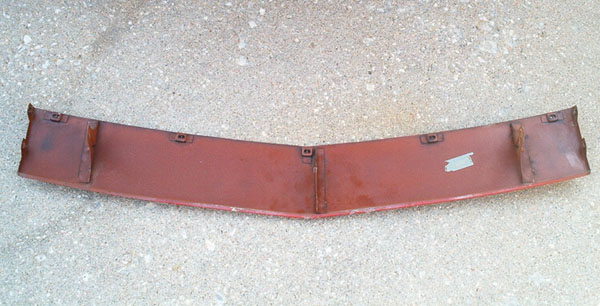

January 31, 200916 yr comment_272665 Nice car Zedy; I like the clear signal lenses on silver. But she does have a bit of a chin on her? When we talk about front spoilers, I always like to throw in these pictures. We'v talked about this before - somewhere buried in the library. The BRE type is very common but the questions raised about mounting it and stability are valid. Just ask Carl what happens to those metal valance panels when you whack on the spook! :eek: Nissan did make a front chin spoiler however it was not imported. The need for downforce was recognized by Nissan. This "urethane / foam" flexible type spook mounted to valence panels that came with captive nuts. And this is what it looks like.... Link to comment https://www.classiczcars.com/forums/topic/30667-front-end-spook-options/?&page=2#findComment-272665 Share on other sites More sharing options...
