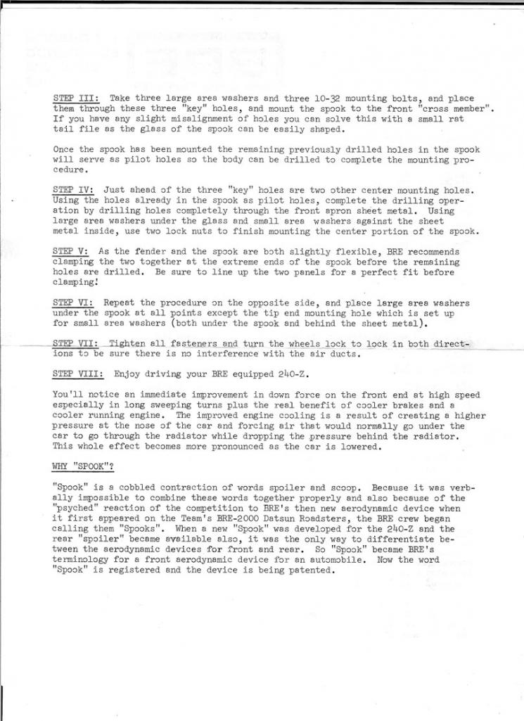

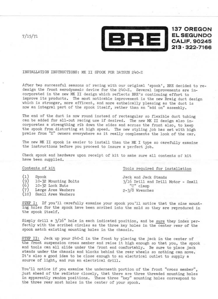

May 3, 200915 yr Author comment_282554 One question, since I was in a rush, I did not have time to follow Arne's advice to do a trial fit and drill out the spook prior to paint. I sort of mocked it up, but realized there is no template for how the spook should be mounted. How far up or how far back should I mount it? Link to comment https://www.classiczcars.com/forums/topic/30667-front-end-spook-options/?&page=7#findComment-282554 Share on other sites More sharing options...
May 3, 200915 yr comment_282558 Just use fresh and good quality Masking Tape - over the paint where you intend to drill though. Use a sharp center-punch to start and hold the drill bit in the correct place. The BRE Spook bolts to the bottom of the Radiator Core Support - with three bolts that go into the existing captive nuts. Look at the underside of the core support and you should see them... If you look closely at the Spook - it should have three little circles scribed in the fiberglass - where the Spook overlaps the bottom of the radiator core support.. If the body shop sanded and then painted the Spook - you may not be able to find the scribed circles that show you where the bolts should go though... See BRE's mounting instructions... FWIW, Carl B. Link to comment https://www.classiczcars.com/forums/topic/30667-front-end-spook-options/?&page=7#findComment-282558 Share on other sites More sharing options...
May 3, 200915 yr Author comment_282561 THanks, I will post pics as I make progress... stay tuned, news at 11 Link to comment https://www.classiczcars.com/forums/topic/30667-front-end-spook-options/?&page=7#findComment-282561 Share on other sites More sharing options...
May 4, 200915 yr comment_282566 Carl Beck said: Just use fresh and good quality Masking Tape - over the paint where you intend to drill though. Use a sharp center-punch to start and hold the drill bit in the correct place.The BRE Spook bolts to the bottom of the Radiator Core Support - with three bolts that go into the existing captive nuts. Look at the underside of the core support and you should see them...If you look closely at the Spook - it should have three little circles scribed in the fiberglass - where the Spook overlaps the bottom of the radiator core support..If the body shop sanded and then painted the Spook - you may not be able to find the scribed circles that show you where the bolts should go though... See BRE's mounting instructions...FWIW,Carl B.Good comments, and the 35+ year old instructions are great to see - now. But my recent experience is that the instructions may not be much help. Carl Beck said: The BRE Spook bolts to the bottom of the Radiator Core Support - with three bolts that go into the existing captive nuts. Look at the underside of the core support and you should see them...Correct in theory, but not always so in practice. I tried hard to figure how to use those three core support holes, but could not get there from here. In my car's case, the front valance is too much lower than the core support. The spook has a step molded in it to accommodate the difference, but the difference in my car is much greater than the step in the spook allows. When I mounted my spook to the valance, the step area is at least 1/4" below the core support.My '71 has never been hit up front, and all the parts there are original. So all I can assume is that the molds have settled/warped/changed over the ensuing 35+ years, or that there are significant production variances between cars, and I caught the far extreme. Or perhaps a combination of the two.In any case, get a friend and carefully test fit the spook to your particular car before drilling any holes. Carl Beck said: If you look closely at the Spook - it should have three little circles scribed in the fiberglass - where the Spook overlaps the bottom of the radiator core support..Maybe. I bought my spook from CDM about 2 years ago, it came with no hardware and no instructions. It also did NOT have the hole guides scribed in. There was no indication at all of how many holes to use, or where said holes should be located. I can only assume (since CDM is supposed to have/use the original molds) that the mold has been re-worked and re-polished over the years and no longer has the scribe-marks. So you may have to wing it a bit on where to drill. Measure and fit several times.... Link to comment https://www.classiczcars.com/forums/topic/30667-front-end-spook-options/?&page=7#findComment-282566 Share on other sites More sharing options...
