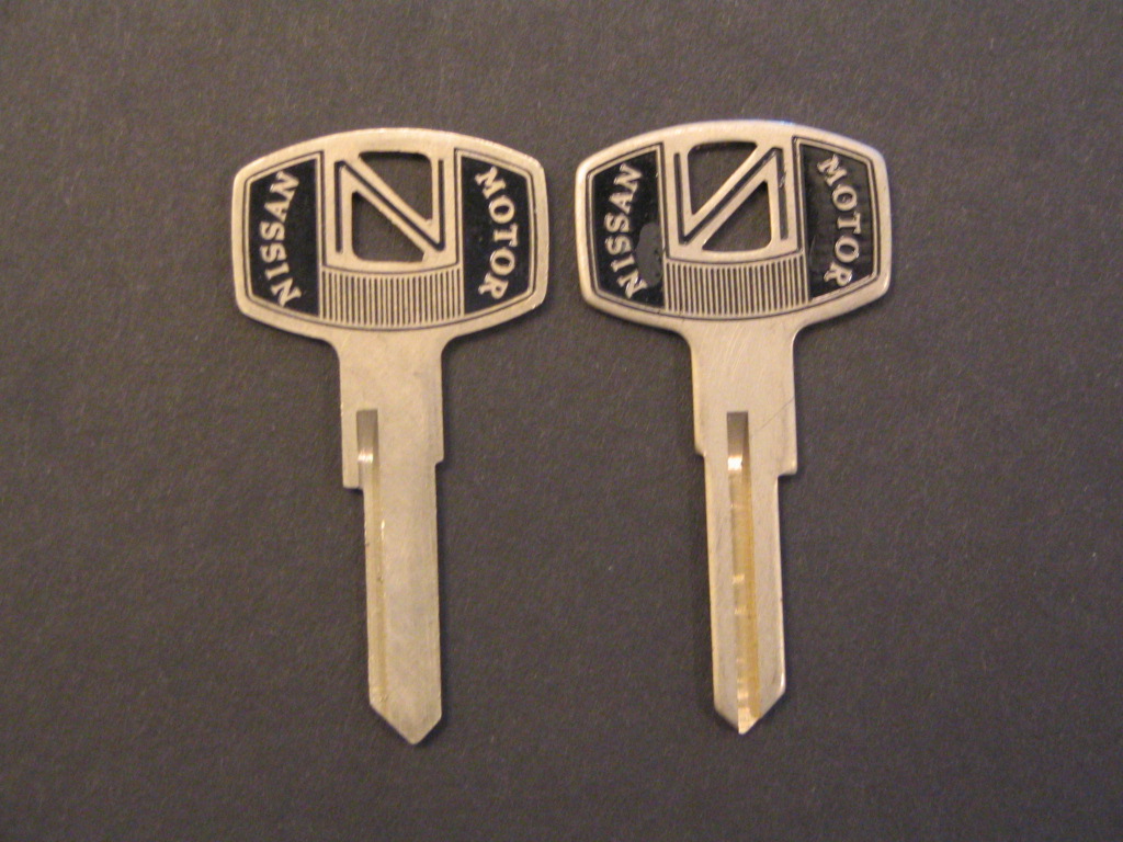

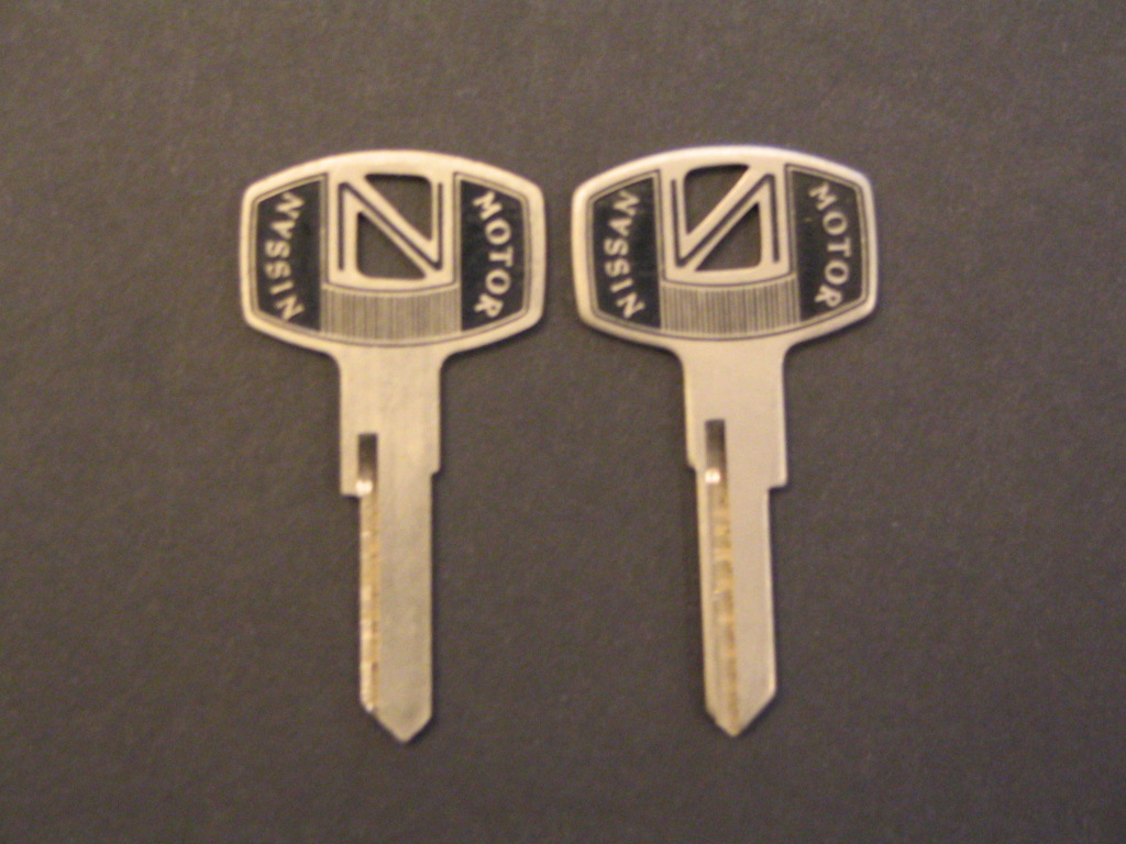

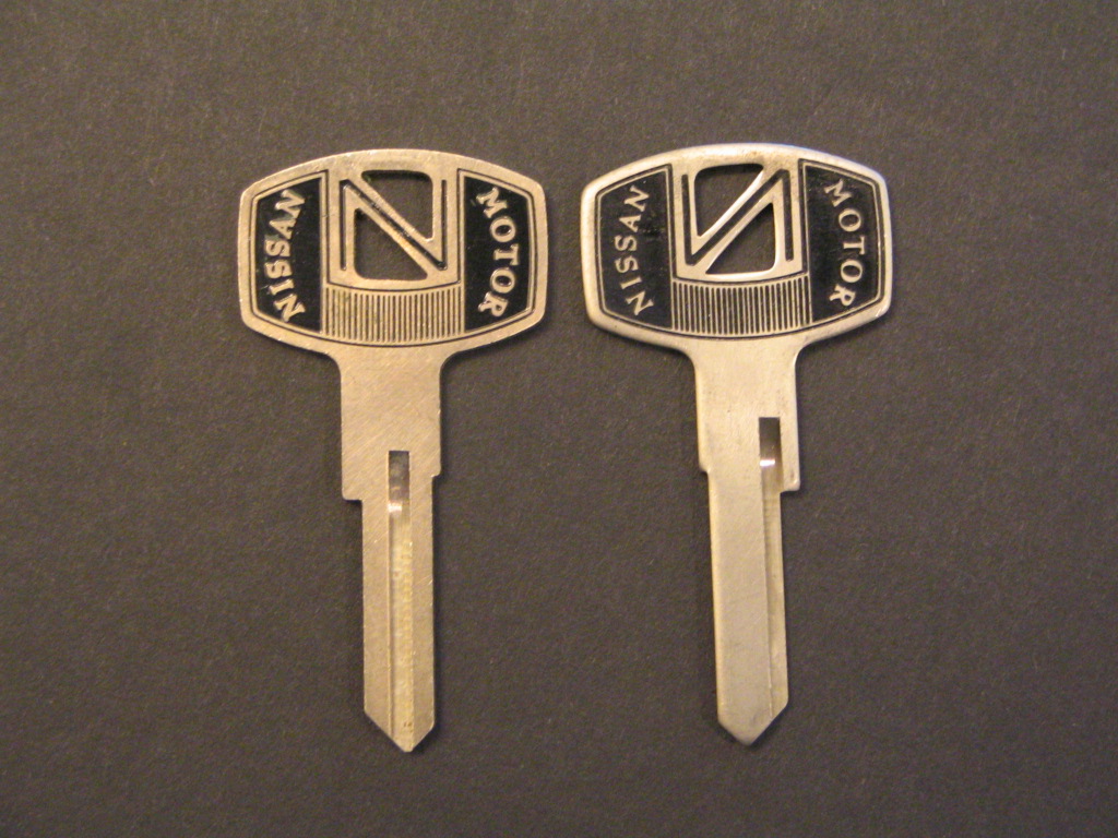

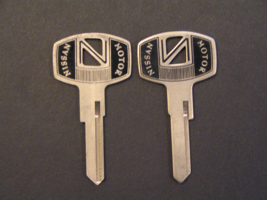

February 1, 200916 yr comment_272819 John, I am not a locksmith, but I think there is still some confusion here. Series one cars have two separate and very different single sided keys: one for the ignition and one for the doors, hatch and glove box (let's just call it a door key now for simplicity). The keys have different groove profiles (keyways) so you can not get a series one ignition keyed to match a series one door key. That is why series one cars have two different key codes, one for the ignition and one for the doors. The ignition key is made of steel and for the US market they were all the VOSS type (see the first picture below). There were four different door key blanks (see the next four pictures below). Cars would randomly get a one of the four types of door keys when they were built. The groove profiles are different so they are not interchangable. The ignition key is also about 1/4" longer than the door keys. Series two cars have one double sided key that works the ignition and all the other locks on the car. There are two types of series two key blanks (a left and a right groove pattern). Like the four types of series one door blanks, they are not interchangeable. What type of ignition do you have now? Single sided or double sided? If you get a used series one ignition you will still have a separate ignition key whether you get it keyed to your original ignition code or not. That is how they came from the factory. -Mike Edited February 2, 200916 yr by Mike B Correct ignition key referrence Link to comment https://www.classiczcars.com/forums/topic/30672-re-key-series-1-ignition/?&page=2#findComment-272819 Share on other sites More sharing options...
