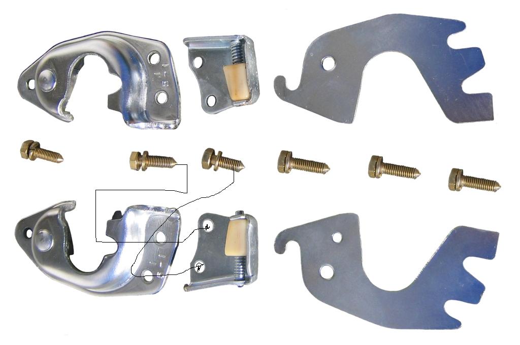

February 4, 200916 yr comment_273088 1. Put the striker on with the top screw only. 2. Slip the spacer behind the striker. 3. Line the springy thingy up on top of the lower two holes of the striker. 4. Insert the two lower screws and tighten. You'll notice that the springy thingy has a spacer spot welded on the back. Link to comment https://www.classiczcars.com/forums/topic/30712-240z-door-hardware/#findComment-273088 Share on other sites More sharing options...
February 4, 200916 yr comment_273089 Heres a pic of the striker with the 'springy thing'...http://www.classiczcars.com/photopost/showphoto.php?photo=11970 Link to comment https://www.classiczcars.com/forums/topic/30712-240z-door-hardware/#findComment-273089 Share on other sites More sharing options...

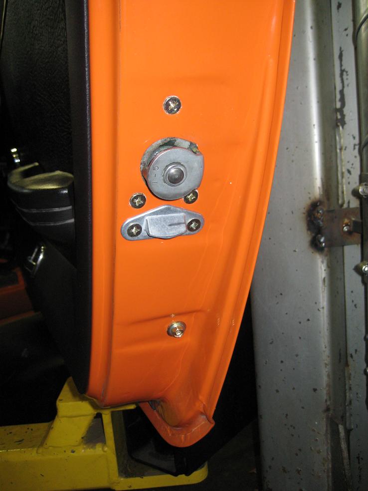

February 4, 200916 yr comment_273092 Heres a pic of the door with the dovetail and the other thingy.. Link to comment https://www.classiczcars.com/forums/topic/30712-240z-door-hardware/#findComment-273092 Share on other sites More sharing options...
February 4, 200916 yr Author comment_273094 Oh okay I understand exactly where it goes now. I want to buy all new door hardware for the door jams, but I can only find the striker brand new. The spring piece and the flat piece that goes underneath are nowhere to be found. Does anyone know if this door hardware is still available anywhere? Link to comment https://www.classiczcars.com/forums/topic/30712-240z-door-hardware/#findComment-273094 Share on other sites More sharing options...
