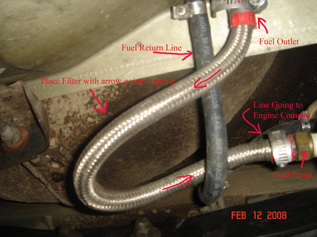

February 13, 200916 yr Author comment_274019 Here are some pics<a href="http://s593.photobucket.com/albums/tt17/vag8r/?action=view¤t=Tankpump.jpg" target="_blank"><img src="http://i593.photobucket.com/albums/tt17/vag8r/Tankpump.jpg" border="0" alt="Z pump"></a><a href="http://s593.photobucket.com/albums/tt17/vag8r/?action=view¤t=fuelpump.jpg" target="_blank"><img src="http://i593.photobucket.com/albums/tt17/vag8r/fuelpump.jpg" border="0" alt="Z FP/FF"></a> Edited February 13, 200916 yr by genova Link to comment https://www.classiczcars.com/forums/topic/30790-how-to-hotwire-a-fuel-pump/#findComment-274019 Share on other sites More sharing options...
February 13, 200916 yr comment_274034 Well I can not see the pictures. The link is broke to me. The line from the tank to the fuel pump is going to be 5/8". You should run the hose so it will loop around. Make sure you filter is placed so the arrow is going with the flow of gas. Now sometimes you will have to prime the fuel to the filter by hand. A new filter has a lot of space for that pump to fill with fuel. My pump would never pull enough to prime the pump. I always put the fuel line set-up together attach to the tank and then put a little suction on the line to get fuel through the filter being very careful not to injest any fuel. It tastes worst than a BBQed possim on Thankgiving. Link to comment https://www.classiczcars.com/forums/topic/30790-how-to-hotwire-a-fuel-pump/#findComment-274034 Share on other sites More sharing options...
February 13, 200916 yr Author comment_274096 280 master I think that you hit my nail on the head. At least I hope so. I have read the chapter in the FSM on the Fuel system and double checked everything I have come to the same conclusion. I am going to work on it this week end and that is the first thing I am going to do.I have the FSM for a 76 & the Fuel Inj. Bible down loaded off of the blue site.I know everything is hooked up correctly.The one thing that haunts me is that I put in a after the Fuel tank filter on the advice of some on here. They recommended the Fram G3. The nipple or outlet on my fuel tank is almost .5" how can you fit a Fram G3 and hose on to that? Is there some adapter? or do you just pull super stretch? I would rather have a see thru filter but can not find one that fits the tank. I have a G3 and the hose to install it. I am going to be under there this weekend and I can change it out if someone can tell me how to make it fit?Any takers? Link to comment https://www.classiczcars.com/forums/topic/30790-how-to-hotwire-a-fuel-pump/#findComment-274096 Share on other sites More sharing options...
