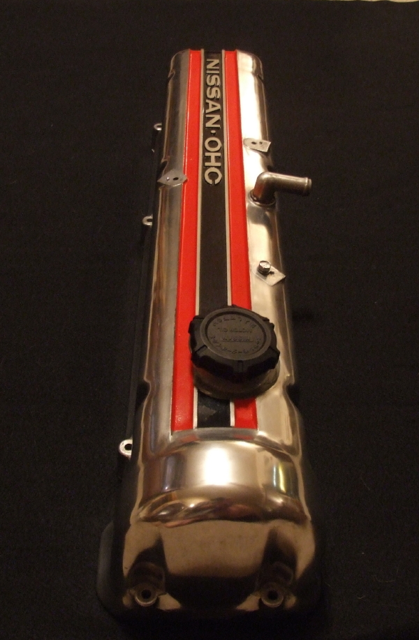

February 19, 200916 yr comment_274819 Do you have any pictures of the "nicks" and "scratches"? You may be facing a job of sanding prior to polishing. Many of us have refurbished these things so I'm sure if we saw what you were talking about you'd get some good advice. (For cam covers, check out the photo gallery - lots of pictures by many members.) Link to comment https://www.classiczcars.com/forums/topic/30877-aluminum-polish/#findComment-274819 Share on other sites More sharing options...
February 19, 200916 yr comment_274821 Polish will only shine the metal that is smooth and blemish free. If you have scratches or nicks you will need to lower the surrounding level of metal down to the bottom level of the scratch or nick. Now having said that , polish will remove some metal , not much but a little. Light surface blemishes can be removed with polish with a lot of rubbing. So if you want to remove a scratch , buy some 1500 grit wet/dry sand paper and use water or kerosene to wet the paper and remove the metal and blend in the scratch. Then I use a buffing wheel on either a die grinder or on my drill press and some polishing compound to buff out the light scratches left by the 1500 paper. Also try some 0000 ,4 ott, steel wool, with any liquid aluminum polish. I know of no short cuts , it just takes time. Gary Link to comment https://www.classiczcars.com/forums/topic/30877-aluminum-polish/#findComment-274821 Share on other sites More sharing options...

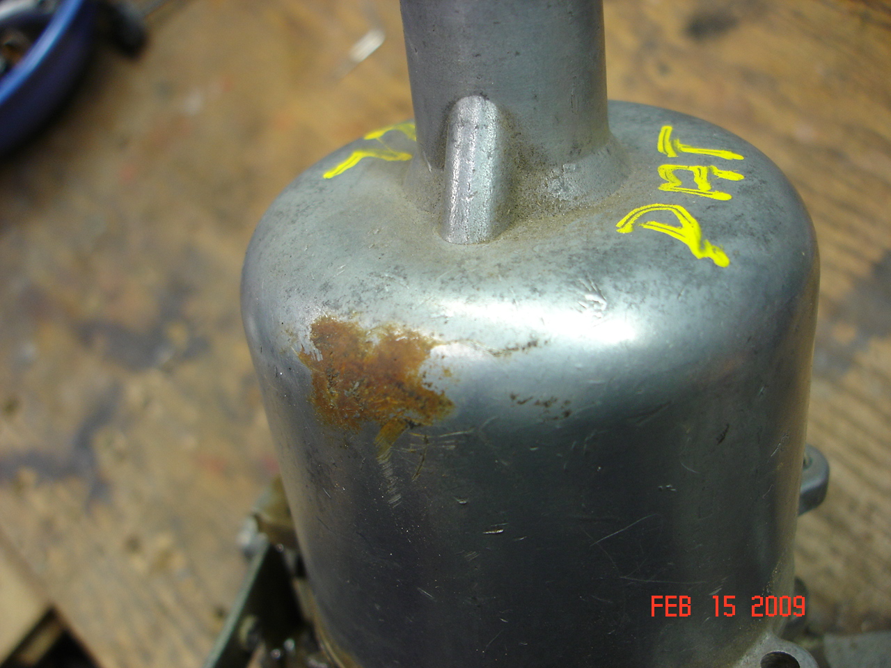

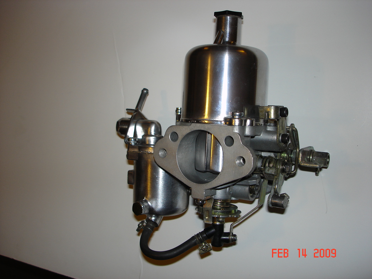

February 19, 200916 yr comment_274828 hollelujaw brotha. Elbow grease, sweat, tears and a whole lotta sanding and polish. Look at the carb forum, you'll see the domes I just did. They are small and still took about an hour and a half each. Those, compared to a whole valve cover = time and patience. Have fun, the end result is well worth the effort. Dave. Link to comment https://www.classiczcars.com/forums/topic/30877-aluminum-polish/#findComment-274828 Share on other sites More sharing options...

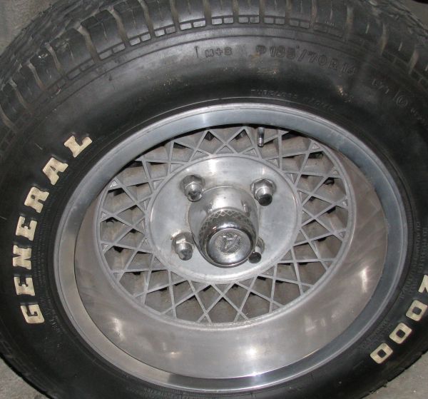

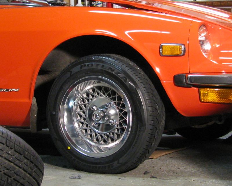

February 20, 200916 yr comment_274882 on my wheels I did light wet sanding with 1500 grit then 2000 grit paper. Then switched to eagle1 polish on a Mothers powerball mini until it shreaded. Losing hope at that point I switched to Mothers Billet polish: http://www.mothers.com/02_products/05106.html and a couple drill mounted buffers from the local Harbor Freight: http://www.harborfreight.com/cpi/ctaf/displayitem.taf?Itemnumber=34743 http://www.harborfreight.com/cpi/ctaf/displayitem.taf?itemnumber=65001 on the other 2 wheels I've done so far I did more sanding, even starting with 600 paper, since as they said above the polish won't take out much of an imperfection. With the finer grit papers I find it easy for it to gunk up with stuff and actually leave some pretty bad scratches if I don't keep the water flowing. that is when the finish came alive Edited February 20, 200916 yr by ta240 Link to comment https://www.classiczcars.com/forums/topic/30877-aluminum-polish/#findComment-274882 Share on other sites More sharing options...
