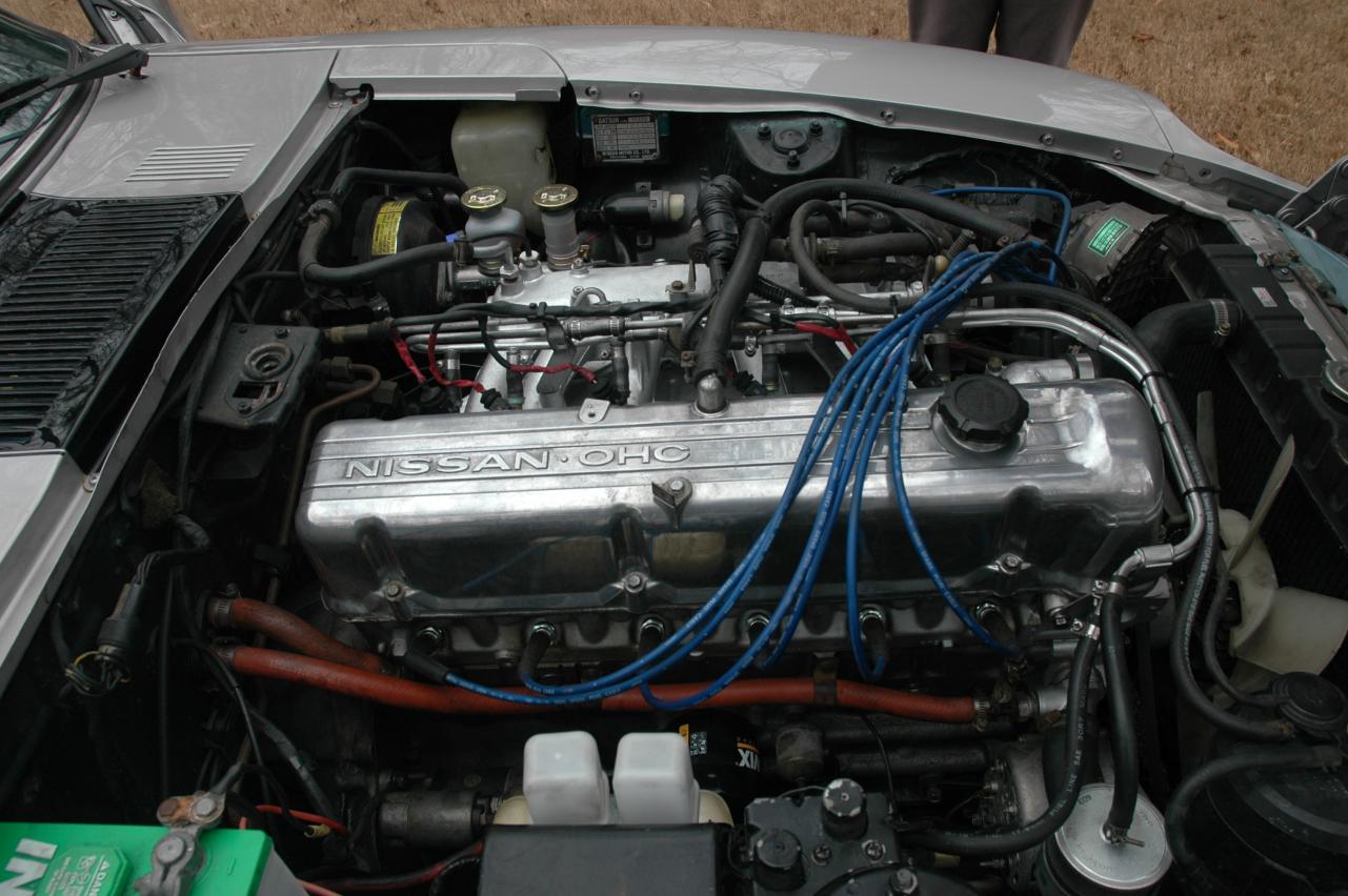

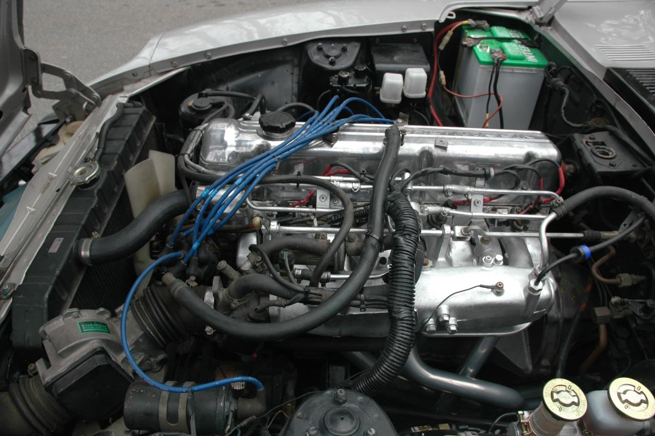

February 25, 200916 yr comment_275345 Perhaps you could post some detailed engine pictures and let the experts here identify which specific components you have. Since it's possible to mix and match just about everything there's no way to be certain. Link to comment https://www.classiczcars.com/forums/topic/30924-what-year-engine/?&page=2#findComment-275345 Share on other sites More sharing options...
February 25, 200916 yr Author comment_275372 I'm attempting to attached photos. Lets hope they take. If not I have posted pictures in My Album under 1978 280Z Engine. Again thank you for all your help. Link to comment https://www.classiczcars.com/forums/topic/30924-what-year-engine/?&page=2#findComment-275372 Share on other sites More sharing options...
February 25, 200916 yr comment_275378 That's definately a P79 judging by the hole for the cylinder head temp sensor which you won't use on a 78 so you need to plug that. Other than that, use the 78 specs as far as tune up and the components that match the 78s electronics and fuel system and you shouldn't have any problems. Link to comment https://www.classiczcars.com/forums/topic/30924-what-year-engine/?&page=2#findComment-275378 Share on other sites More sharing options...
