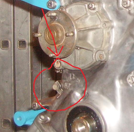

Sean, please post a photo of your timing mark and front pulley, there are two different kinds and they don't mix up.

Your mechanic can quickly check your timing mark/pointer by taking out the number one spark plug, turning over the engine by hand, and stopping when he sees the piston come up to TDC. It won't be super accurate but if he was careful the marks should be within about +/- 5 degrees of indicating zero or TDC. If so, you should be good.

heres the pulley and the marker. this is not the marker i bought but a marker that the mechanic had as extra or one that came off my old motor. im not sure.
I know its not the new one i bought as i painted that one blue.
Also , Mechanic told me today he is going to tdc the engine again by hand with the #1 cyl and compression method. this has already been done once but the crank mark was way low, near oil pump last time he checked it. Maybe this is a clue? Revving only to 4500 not 5400 rpm. rebuilding carb did not fix issue. I think cam/crank timing is off.
