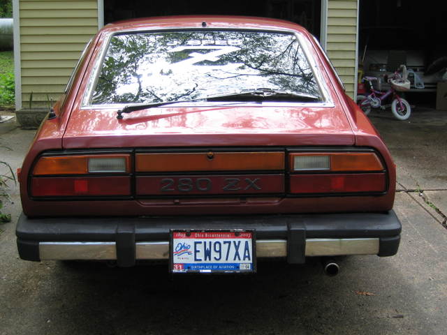

Im looking at purchasing a 79 j-spec fairlady z 280. it has signifigant frame rail rot on the passenger side. enough to the point that im considering not getting it. but when i look i found baddogparts.com and a few other resources that led me to think this might not be all that uncommon or massively detrimental . the it rots from just forward of the front bend to almost all the way to the rear bend the whole bottom side is rotted out and the sides are almost gone. can anyone tell me 1- how signifigant this is, and 2- how easy it might be to fix this and 3- how much this is worth against his asking proce (2500) its in good conditin otherwise, minor scratches and surface rust and like i said until i saw this i was about to cut a check on the spot. thanks guys, if i get this car im going to be getting more into the scene and it would be great to see another scene thats as helpful as some of the others i have been around.

Replacing the rail is possible, but unless you are going to do it, expect to add $1000 or so to your budget, between having the area trimmed, the new part fitted and welded in...better to over estimate than to underestimate.
Be aware, if there is significant rust there, there is probably more...check it out thoroughly, or get a well versed member to have a look.

I would walk away. Even what you described sounds like a huge project, and you should expect it to be worse. I had only a little bit of visible frame rail rot and it turned out i had to replace floors, rockers, and rails. It took a long time and the work had to be corrected once because the floorpans didnt line up properly. For the money and time it cost to fix a cheap car I could have gotten a much better car for the price of the rails/floors/rockers alone.
Seriously inspect this car over if you're entertaining the idea of buying it. Take a little pick or screwdriver and poke at everything. I'm certain you'll find more rot waiting for you thats hidden by paint, undercoating, or grease.

Its an S130, there's no question about that, though not a 280ZX. There was no 1979 S30.
I suspect you're right but either way we don't have all of the information from the original poster. However, gnosez seems to have inside information that isn't part of this thread. Based on that I still think replacing the frame rails will be a problem. I'm not aware of aftermarket rails for an S130.
