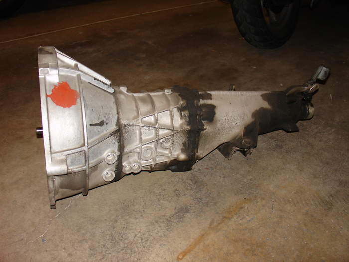

March 4, 200916 yr comment_276164 Hugh, the Type A is correct for your car, and is the one with the goofy shift linkage, AKA "monkey-motion" shifter. Mine is pictured below. I rebuilt mine about 18 months ago. I'll dig up my parts notes and post what I used and where I got them later tonight. Link to comment https://www.classiczcars.com/forums/topic/31021-transmission-question/#findComment-276164 Share on other sites More sharing options...
March 4, 200916 yr comment_276166 To be even more clear - if your 4 speed's chrome shift lever is straight, and bolts through a pair of rubber bushings in the linkage on the transmission, it is an F4W71A. If the lever is bent and has plastic bushings that mount in a hole for the lever to pivot upon, it is the later Type B 4 speed. Link to comment https://www.classiczcars.com/forums/topic/31021-transmission-question/#findComment-276166 Share on other sites More sharing options...
March 4, 200916 yr Author comment_276167 Arne,Mine looks a bit different than the one you posted, there is an upright fork that the shift bar fits down between secured with a pin and two nylon bushings and there is a long flat bolt down plate forward of that. Could it be a F4W71B??Best, H Houghton Link to comment https://www.classiczcars.com/forums/topic/31021-transmission-question/#findComment-276167 Share on other sites More sharing options...
March 4, 200916 yr comment_276168 Yup, that sounds like a Type B, as used from '72-78. My parts list won't help on that one, about the only thing that's the same are the synchro rings.Another way to tell is whether the bell housing is separate, or cast as part of the main case. The F4W71A has a separate, bolt-on bell housing, the F4W71B's bell housing is part of the main case.So is your tunnel opening enlarged, or has your shift lever been customized to allow it to work in the earlier tunnel opening? Link to comment https://www.classiczcars.com/forums/topic/31021-transmission-question/#findComment-276168 Share on other sites More sharing options...
