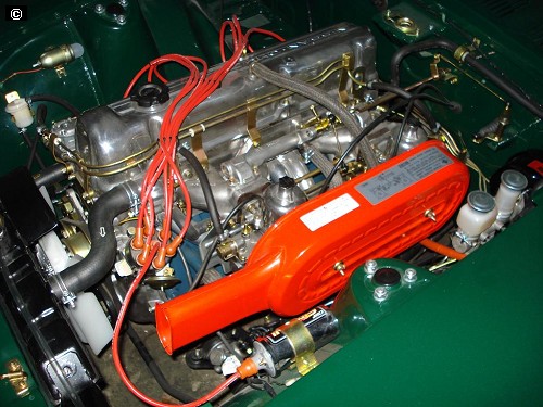

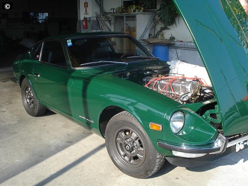

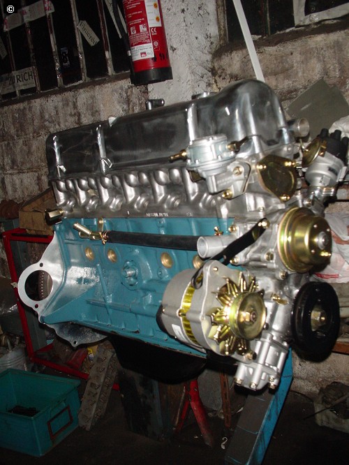

March 9, 200916 yr comment_276878 Hi Chris Why are you asking that? is there any case related to that... so here goes what`s happen with me. I did a big restoration on my car , and engine was one of the parts that i restore as weel. I changed the piston rings, timing chain kit, gas, water and oil pumps, new hoses, etc... At beninig I run it and felt like the carbs were stop working and the engine stop working too and i was forced to pull side of the road. I changed the correct termostat degrees for 76.5 C, not 81C, because i saw a little high tempetarure on gauge them normal. I change it and keep it running and he did it again for a couple of times (only)... Now i put new carbs and everything works fine... but still don`t know what it was... Now i have a friend that has this problem as well, and i want to help him, the engine was redone, and car works fine at idle readlly good engine sound, but at road he can not put the throttle down as car might stop working. The carbs or engine start to fail and he has to pull over and wait a little of time, them it starts again and run a little better... Any solutions? Filipe Azevedo Link to comment https://www.classiczcars.com/forums/topic/31050-240z-runs-very-rough-hot-intermittently/?&page=3#findComment-276878 Share on other sites More sharing options...
