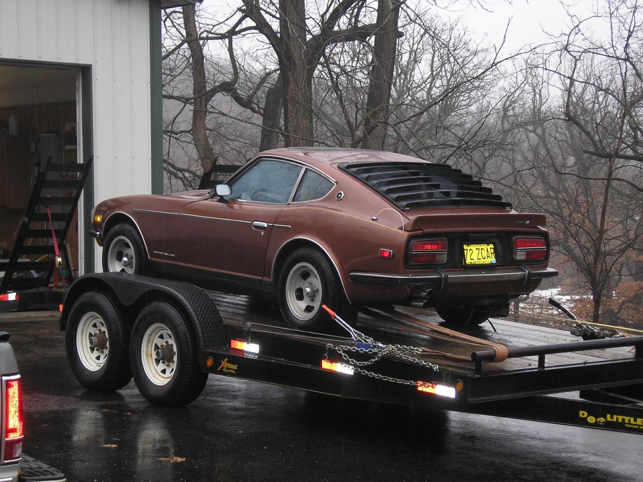

Posted March 8, 200916 yr comment_276796 Hello, I am new here but an old friend to Z cars. Great website with lot's of help - nothing like restoring during the late 70's early 80's- . Yesterday, I brought my 72 240 home from 23 years of commercial storage. Cripes I could have bought the building it stored in for the rent paid! Back then, I replaced every body panel but the roof, floors & frame rails,- the engine, tranny, brakes etc were aok when last shut off. But alas, the corrosion caught up to me making it undriveable. If I remember, it was all of 12k 1984 dollars. The front fenders and valence are fiberglass- whatever became of that company?? I thought they made a pretty good product. Can I replace the rails & floors not using a rotisserie? I'll pull the engine & tranny, remove the front steering/suspension completely, and strip the interior. It just breaks my heart to have to disassemble much more I'd like to leave the fenders on. If so, how can I support the car while doing the rails?? Are Charlie's frame rails slip on or do you remove the originals completely? Maybe do the floors first and support across that while doing the front? How could I raise the car higher once it is stripped? Any advice is appreciated, Link to comment https://www.classiczcars.com/forums/topic/31097-how-can-i-make-repairs/ Share on other sites More sharing options...
March 8, 200916 yr comment_276797 Car looks terrific after 23 years in moth balls!Exterior looks fantastic for a hangar queen; did you change the tires or just add air?Love your license plate!Weather in Wisconsin looks wose than lousy ...... spring is coming?I cannot answer your questions on frame rails but I am sure somebody on this site has the answer. Link to comment https://www.classiczcars.com/forums/topic/31097-how-can-i-make-repairs/#findComment-276797 Share on other sites More sharing options...

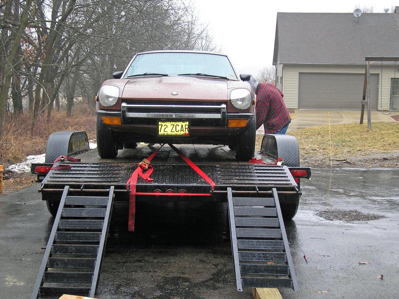

March 9, 200916 yr Author comment_276806 Thanks, the tires were flat to the rims with sidewall cracking you could stick a finger inside. That was a large reason I left the car alone. Turns out they just needed a refill- . We had to drag it out with a tow strap but after a short distance, something gave (!) and it rolled free. The engine oil is golden, ATF is bright red, there was oil in the upper head hex bolts, 1/2 tankful of gas, oil in the carbs and carb pistons slide freely up & down. Right now, marvel mystery oil is working its way down past the the piston rings. before I attempt to hand turn it over. By luck or otherwise 9 valves were closed and 3 open during the sleep. In a couple of days, I'll get a new battery and try to start it with a small can of gas connected to the fuel pump. The weather is cold & wet. A real drag laying on the ground while connecting the straps & tie downs. Gotta say, it is much better than the deep freeze of a couple of weeks ago.Since it was off the road,I gave up rights to the plate. Now I'll get our blue collectors plate- a 1x fee of 30 bucks or so for lifetime! I am beginning to be inspired again. Zcar,Zcar,Zcar Link to comment https://www.classiczcars.com/forums/topic/31097-how-can-i-make-repairs/#findComment-276806 Share on other sites More sharing options...
