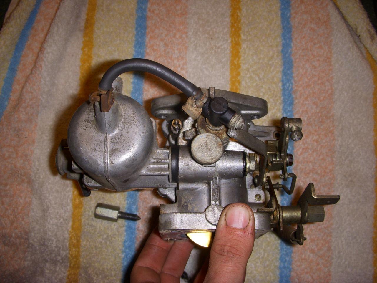

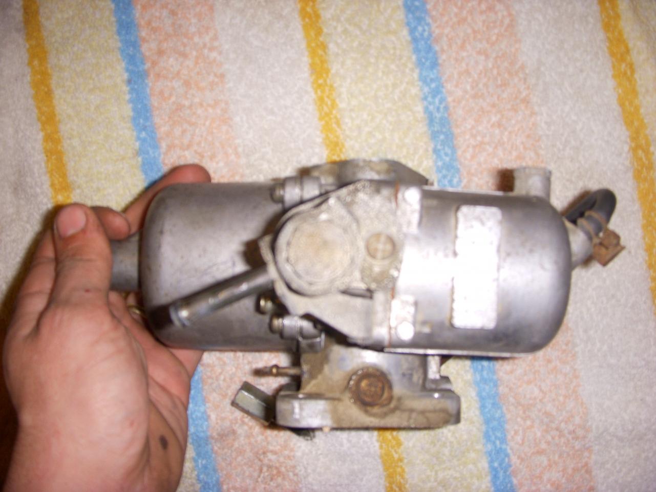

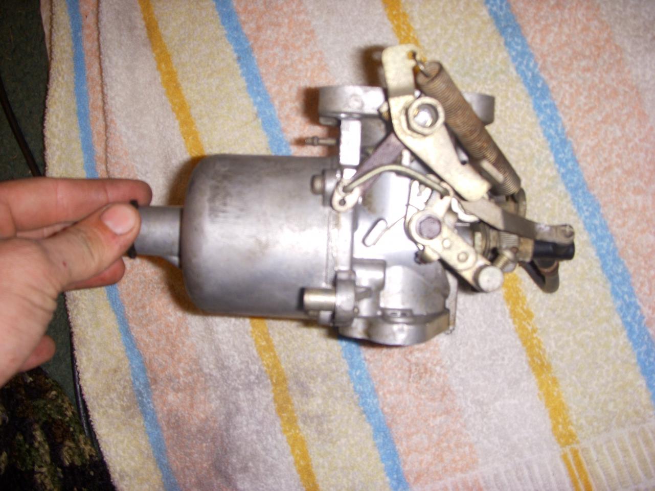

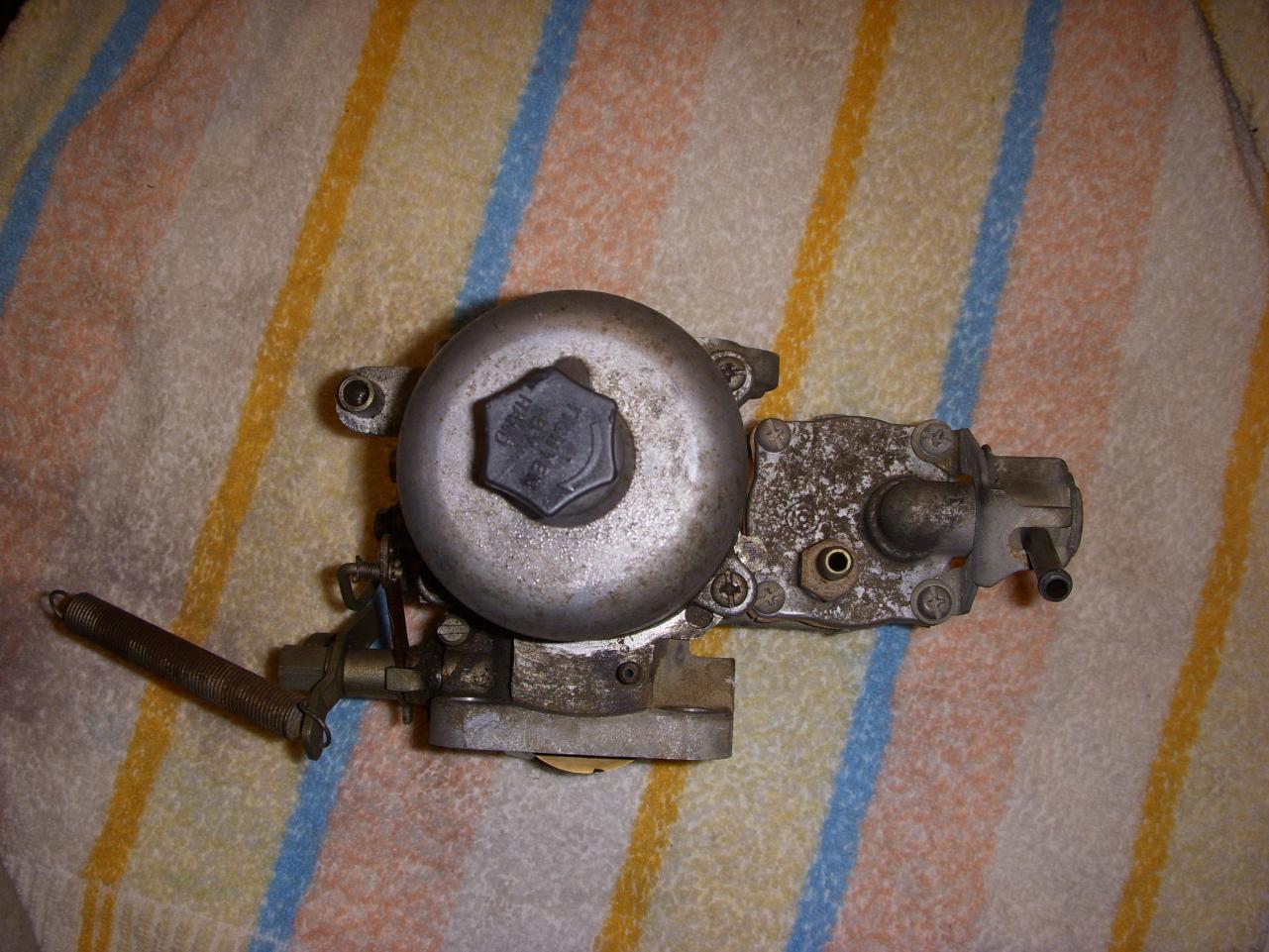

Hello i have a set of carbs that i ordered off ebay .I can not read the numbers on them. Here are the numbers i can make out 1601H. That mite not be write but thats what it looks like.
https://www.classiczcars.com/forums/topic/31100-identify-my-carbs-please/
I'm not so sure, Will. I think the angle of the photo from the top is bad and we can't see the other two dome screws. I don't see any sign of the coolant passages in the bottom. So I think they are 4-screws, from a late '70 or a '71.
