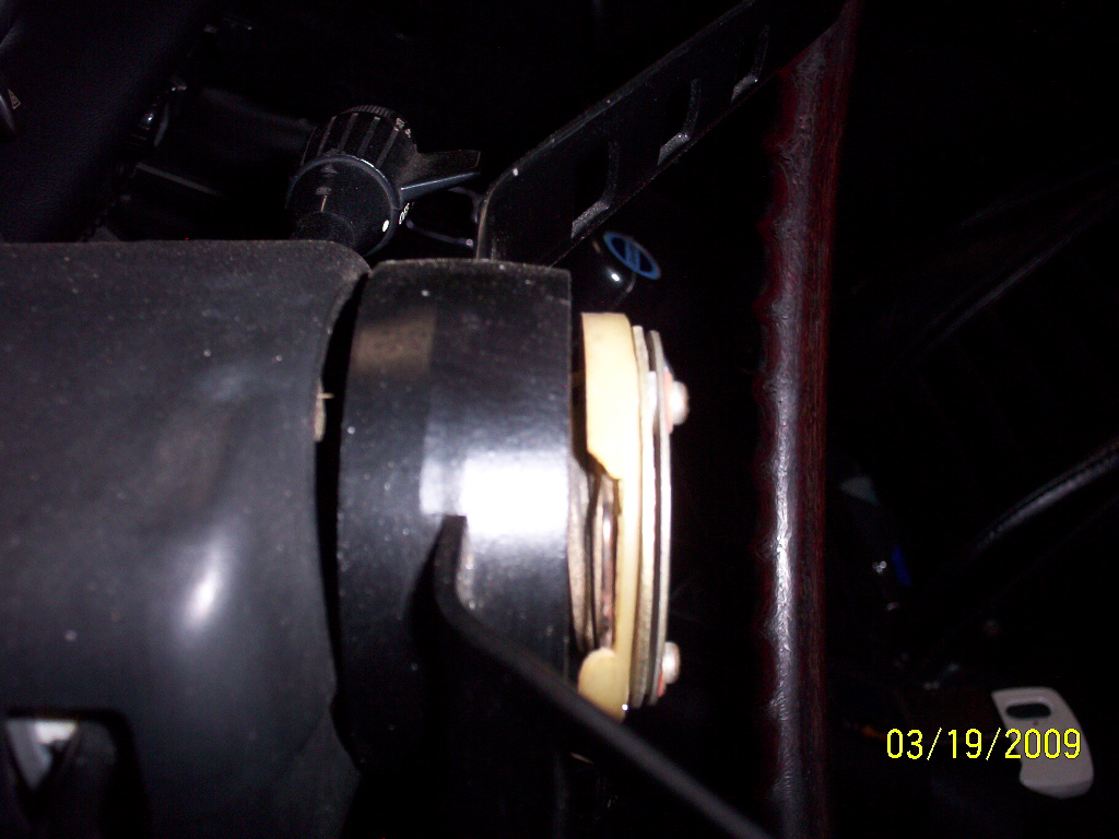

Posted March 19, 200916 yr comment_278108 Replace/fixed? It's off the steering wheel.... Horn button keeps falling on my lap.:tapemouth Edited March 19, 200916 yr by D83zxt Link to comment https://www.classiczcars.com/forums/topic/31225-can-this-be/ Share on other sites More sharing options...
March 19, 200916 yr comment_278111 Cracks in the inner plastic retainer can be fixed {glued}... but if you are missing pieces of it, you are better off getting one in better shape to begin with.FWIW,Carl B. Link to comment https://www.classiczcars.com/forums/topic/31225-can-this-be/#findComment-278111 Share on other sites More sharing options...
March 19, 200916 yr comment_278114 I did a quick search and found this thread that I remembered reading. It may be helpful. A quick fix until you find a better replacement.http://www.classiczcars.com/forums/showthread.php?t=14276&highlight=steering+wheel+zip+tie Link to comment https://www.classiczcars.com/forums/topic/31225-can-this-be/#findComment-278114 Share on other sites More sharing options...
March 19, 200916 yr Author comment_278119 I did a quick search and found this thread that I remembered reading. It may be helpful. A quick fix until you find a better replacement.http://www.classiczcars.com/forums/showthread.php?t=14276&highlight=steering+wheel+zip+tie You're awesome! Thank you! I did search to find out how to restore the steering wheel. Looks like I will be having fun for the next several of days. Link to comment https://www.classiczcars.com/forums/topic/31225-can-this-be/#findComment-278119 Share on other sites More sharing options...
March 19, 200916 yr Author comment_278124 Cracks in the inner plastic retainer can be fixed {glued}... but if you are missing pieces of it, you are better off getting one in better shape to begin with.FWIW,Carl B.Sad to say, It is missing some of the plastic ring around it. I will keep an eye out for a better replacement, and you guys are great for making some parts... do for now... until it can be fixed correctly. Link to comment https://www.classiczcars.com/forums/topic/31225-can-this-be/#findComment-278124 Share on other sites More sharing options...

March 20, 200916 yr comment_278175 I have been having the same problem. My horn button would pop off when I hit a bump or under hard acceleration. Looked at the fix in the post from Geezer, and went out to the garage to see if it would work. My horn button was fine. However, the nylon ring on the steering wheel, with the 3 metal plates that hold the button on, was not 100%. Part of the ring behind (dashbd. side) one of those plates was missing. I checked a spare wheel I had in the attic, and the nylon ring was intact. Pushed the horn button on it and had a hell of a time getting it off! Looks like I'll have to look over the posts about restoring the steering wheel, as this wheel is not as nice as the one in the car. Link to comment https://www.classiczcars.com/forums/topic/31225-can-this-be/#findComment-278175 Share on other sites More sharing options...

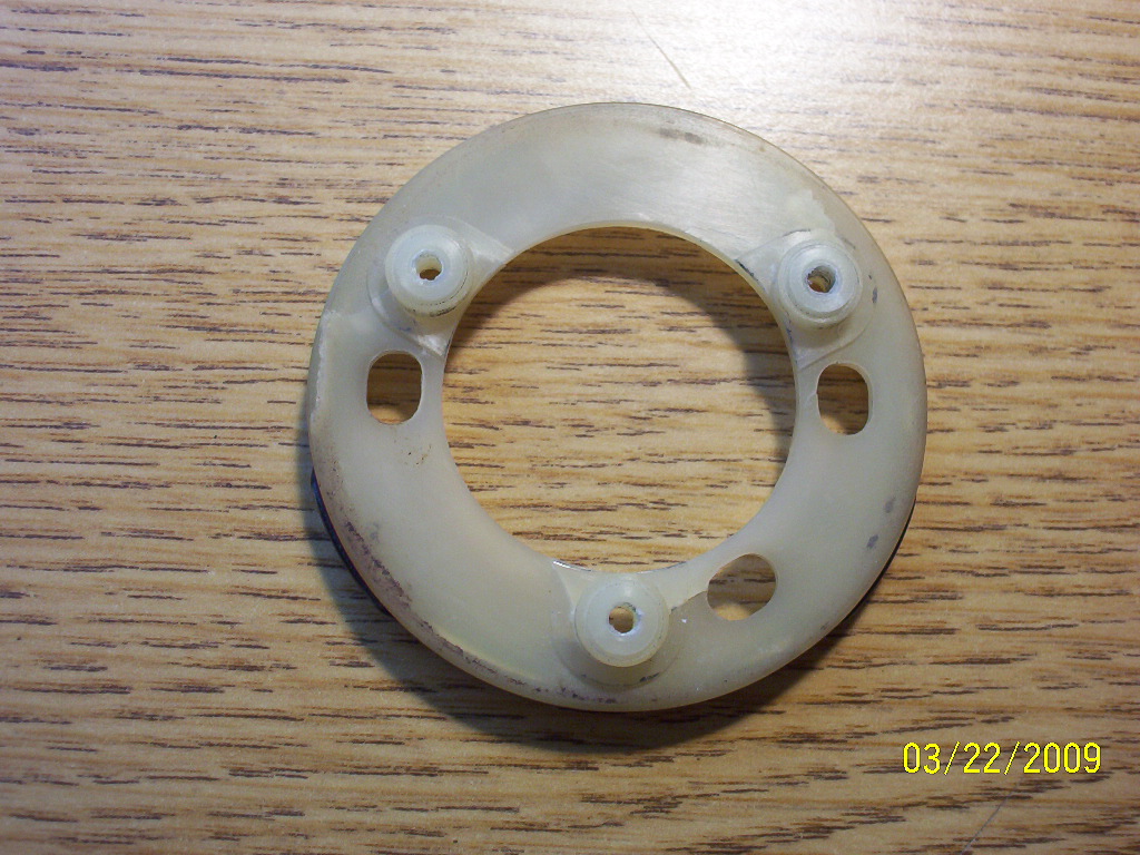

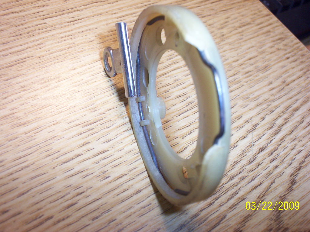

March 22, 200916 yr comment_278506 I dismantled my wheel, and took off the nylon ring. As you can see from the att. pics, it's in poor shape. This might be worth checking if your horn pad keeps coming loose. (What I thought were 3 plates is actually a formed spring.) Link to comment https://www.classiczcars.com/forums/topic/31225-can-this-be/#findComment-278506 Share on other sites More sharing options...
