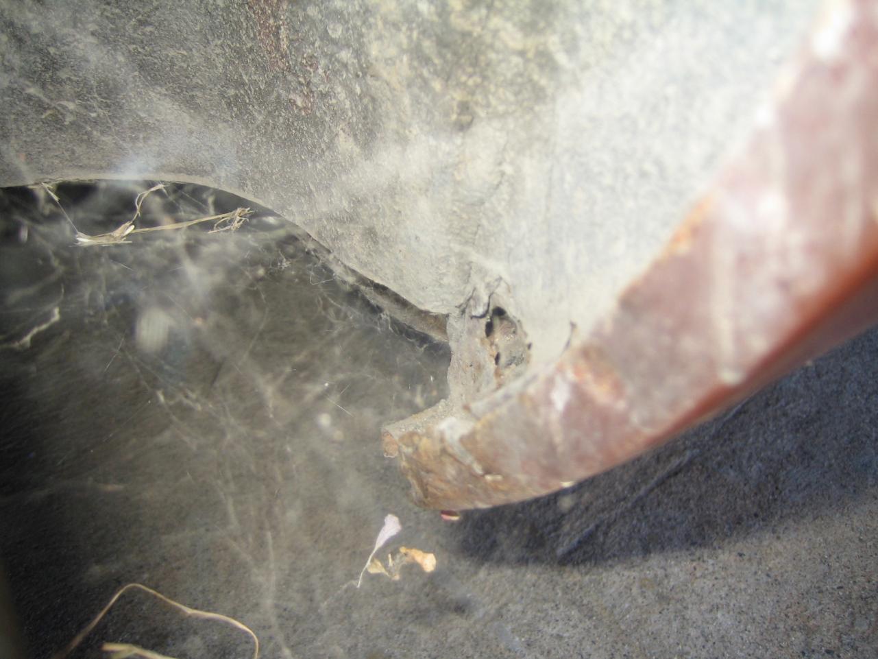

March 28, 200916 yr Author comment_279087 I have been under the car all day. Cutting, grinding and poking on the rust trying to get enough of it cleaned up to make a decision. It is still to early to tell. It looks like the rust extends back to the firewall from the T/C mount but only forward about 4 inches. The rest of the rail forward appears solid. Replacing a section may be just as difficult as replacing the entire piece. Once I have it all clean I can have a better idea of what to do. I am still very much up in the air about this. I will post more photos after it is cleaned up and will take some hints and ideas from the board. I consider myself a very good mechanic, I have a wide range of tools and experience using all of them. I have MIG, air tools (nibblers, die grinders, cut off tools, impacts, etc.) and a large assortment of hand tools. Under the hood and trans I am comfortable. Body skills are average, maybe even a touch below, and I am not a master welder, I can run a bead and spot weld, but nothing special. I have a double long extra wide one bay garage to work with and that is it. Figured this info would help with the advice. Floor board type repairs dont scare me, boxing a frame is something I have done before, but would not weld my own roll cages for NHRA inspection. I have average fabrication skills, brackets, crossmember type work. Replacing the frame seems above those skill levels.What do you think? Honestly. Link to comment https://www.classiczcars.com/forums/topic/31264-update-on-floorpan-rail-replacement/?&page=2#findComment-279087 Share on other sites More sharing options...
March 28, 200916 yr comment_279091 I think you should go for it, just take your time, after all you have the car now. My own car had only minor rust (see photo below) but it had and still have tons of other small issues i have to attend to, small parts in need of replacing or missing, i have to get them from the US pay a lot in shipping and import tax, but one day i will get there and so will you. Maybe you should pull the motor and tranny and put it on a rottesire(i know spell error) it will make things a lot easiet to work on. Chris Link to comment https://www.classiczcars.com/forums/topic/31264-update-on-floorpan-rail-replacement/?&page=2#findComment-279091 Share on other sites More sharing options...

March 30, 200916 yr comment_279235 If this is the case I am sunk for a while as I gather the funds.Anyone have a cure, or am I just going to have to hack it all out and replace. If it goes much further, I am going to have to pull the engine, and front fenders. This is a disaster. Ideas welcomed!Hi Steve:My best advice is - cut your losses short now. Hard as that may be to swallow, it is the best medicine I could prescribe. If you cut and patch, cut and patch... and you wind up with anything less than an original looking undercarriage - - - the car will be fixed - but it's market value will be very low.Looking at the amount of rust under that Z - I would not devote the time and money it will take to fix it properly. On the other hand, if your just building a future street rod, or race car - fixing it "properly" to maintain an OEM vehicle - won't matter.To repair it properly, such that at some future point in time, it would still have the market value of a solid Datsun 240-Z - you would have to replace the original sheet-metal panels with new OEM panels, or very good reproduction parts. NOT just metal patch the hell out of everything.It is a uni-body car - so you would have to remove the damaged panels entirely - buy breaking the spot-welds, then replace them with new panels and re-weld the spots. Given the expense of OEM frame rails, reproduction floorboards - - - and what ever else is rust damaged - - - I would be far better to simply buy a 240-Z with a far more solid body to begin with. There are still lots of 240-Z's on the West Coast that could be far more easily refreshed or restored - and purchased for under $4,500.00.Put your time and hard work into a car that will be worth the effort in the end...FWIW,Carl B. Link to comment https://www.classiczcars.com/forums/topic/31264-update-on-floorpan-rail-replacement/?&page=2#findComment-279235 Share on other sites More sharing options...

March 31, 200916 yr comment_279315 Steve,It looks like you have a lot of work ahead. I had to help make a decision like this for a client the other week. his car however is #379, which gives it a little more value. His car was a little better shape, but still a lot of work. If it had been a little worse, or not #379, or a strong sentimental value, I would have gone with arne's advice and told him to look for another body. If I was asked my opinion on your car based on the pics, I would say take some time and try and find another body before you get too determined with that car. That is some pretty bad corrosion. It depends on how you want to look at it--a challenge to your skills maybe . I travel into Collinsville sometime on the CSX railroad. I'd like to see your car sometime. I'd offer my services, but I think you have the skills and determination already, but do you have desire to do that much work on that car. I wish you all the luck. Link to comment https://www.classiczcars.com/forums/topic/31264-update-on-floorpan-rail-replacement/?&page=2#findComment-279315 Share on other sites More sharing options...
