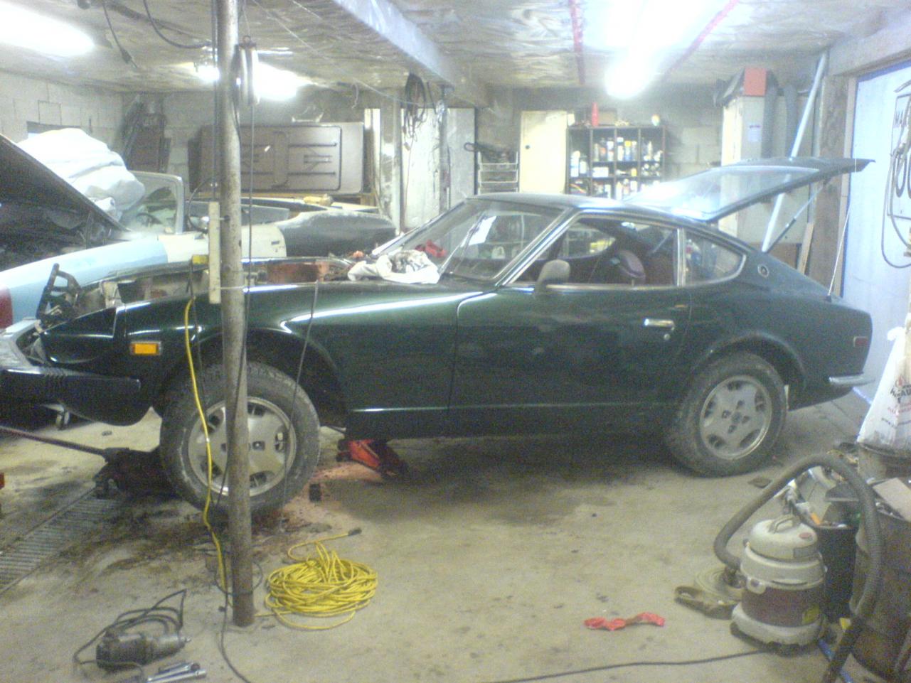

Hi All,
I have a '77 280Z; mostly stock; Fg fenders; I bought it at 32k miles; now 70K..
It was fun with the stock motor but there were frame rails to deal with etc. and I've always loved the 215 / 3.5 L aluminum Buik / Rover V8s.. so;
Starting the swap; have a 3.5 L Range Rover 8.. just took the original motor out (posted in Classifieds; complete and running; no butchery as the rover is complete with harness etc..) and tackling the rust.
Any recommendations re floor pans and frame rails? On that; will be replacing the whole rail set and the floor pans at once. Was going to use the bad-dog rails; may still for the strength, but will have the new 'rad to firewall' rails.
They all look to be the same manufacturer; are they?
At the same time I will be doing rockers with a tube inside, boxing back to the frame front and back with a cage mount as well.
I will run the motor stock to start with.. the twin turbos may come later.
Also, would it make sense to go to a ZX front member / rack etc. at the same time? I have ZX 15 inch wheels now but I remember hearing that the ZX units were better.. true?
Thanks,
Rick
