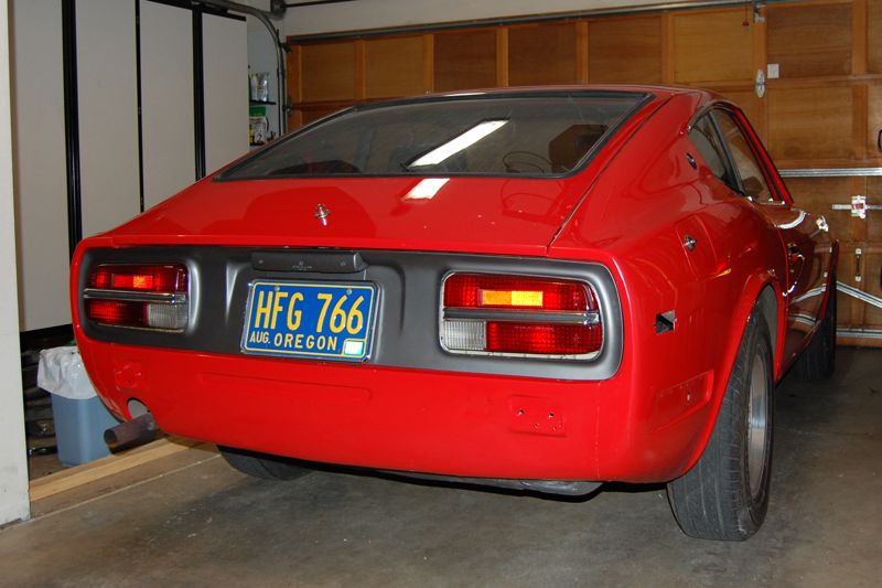

Do any of you have a tail light trim or grill freshly painted in the stock color, i really like to look at some photos of the stock color in order to find a matching rattle can.
Come on guys, let me have some shots:).

I have used classic datsuns spray paint at it looks really good. The paint does "eat" into plastic trim though (tail light trim pannels on my dads 260) but over all a great finnish. For a 240, just the grill and trail light finnisher should be about a can, if you want to do hub caps too, get another can... -Todd

Bear in mind that the original paint had no gloss, it was very dull and somewhat rough in texture. That finish is difficult to duplicate in an off the shelf spray can.
When selecting an accent color for my recent mag wheel refurb project, I found that Plasti-kote Import Color #5432 is very close, almost a dead match. The metallic content is very fine, and since it is designed for a clear coat, the gloss is subdued. If sprayed very dry and light coats, it might make an acceptable substitute. It is actually listed as a Nissan color, Nissan paint code 463 (Dark Gray Metallic), used from 1986-92.

A few weeks ago i called PPG in order to get the grill & tail light panel paint formula published in the "How to restore your datsun Z-car" (California Bill's) book translated in a modern paint formula (Global). This is the formula they provided me. Hoping this help.
Original formula from the book :
Ditzler Duracryl DDL 2862 Argent with quite a bit of suede additive.
1 pint DDL
200 units DX265
300 units DX264
Thin 100-150% and spray fairly dry.
Regulate air pressure to the high side
Make sure you keep the paint mixed in the cup
Don't expect any gloss as it shouldn't have any
