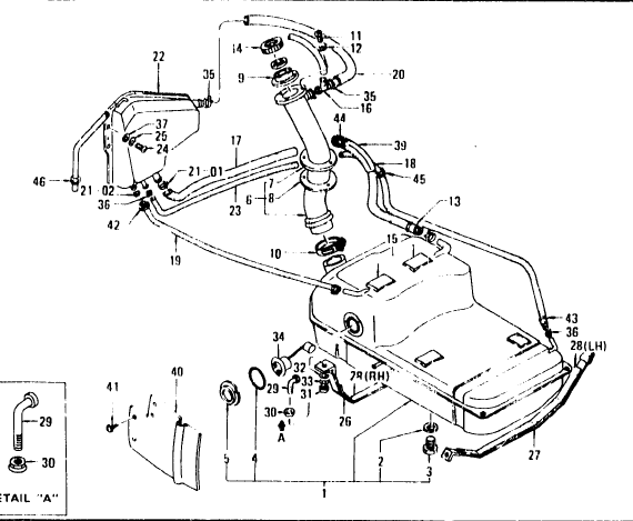

now the HUGE problem that i have found, is it looks like there are 2 vent tubes @ the top of the tank that run into the hatch area they are braided lines and are OG
they are completely rotted away and crushed. I can see no way to change out these lines that run up into the carbody without cutting into the hatch area
Can these lines be capped off? can these lines be rerouted to vent somewhere else ? here are a few pix
The vent hoses go up to the vapor tank in the right pillar area. If you remove the interior plastic trim panels you can see all the hoses. They can be replaced, and if the tank has been dropped already it's not that hard to do.
Or you can rework the system to eliminate the vapor tank, and a few of the hoses. But you can't simply cap them all off, as you need some of them for venting.
