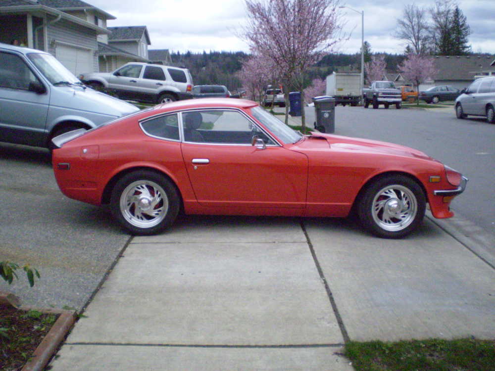

April 8, 200916 yr comment_280123 Jim, I believe that tire availability is the key. I gave up on 14" wheels and skipped over 15" wheels as well due to dwindling availability of quality tires. While there are still some 15" tires in the proper sizes, the selections are getting thinner by the day particularly in performance summer compounds. I went with tried and true Panasports in 16x7, but there are many cheaper choices that bolt right up. If you like the flat face look of modern wheels, you could go with Honda wheels and use spacers to correct the offset and bolt pattern. If you choose 16" wheels, there are TONS of quality tires in any style you need. I went with an ultra high-performance summer tire from Hankook and love them. Don't let the name fool you. Hankook currently has the most modern equipment in the industry and they make very high quality tires. They have tons of grip and are inexpensive. Here is a gratuitous picture Link to comment https://www.classiczcars.com/forums/topic/31428-proud-240z-owner/#findComment-280123 Share on other sites More sharing options...

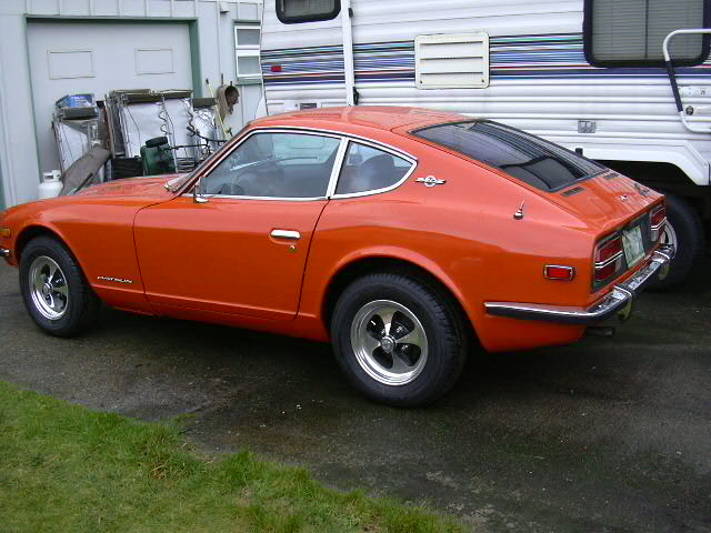

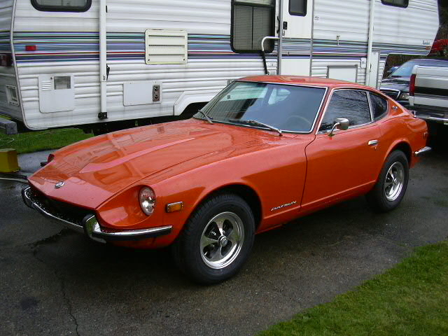

April 8, 200916 yr comment_280134 I am with you Arne; Find another set of these around. Period correct for me. Same wheels on this Z since 1970. Never had any problems with this rubber either. As you said Arne much better handling then with the Z was new with the best tires I could buy. But, then I again my driving is tamer now. Link to comment https://www.classiczcars.com/forums/topic/31428-proud-240z-owner/#findComment-280134 Share on other sites More sharing options...

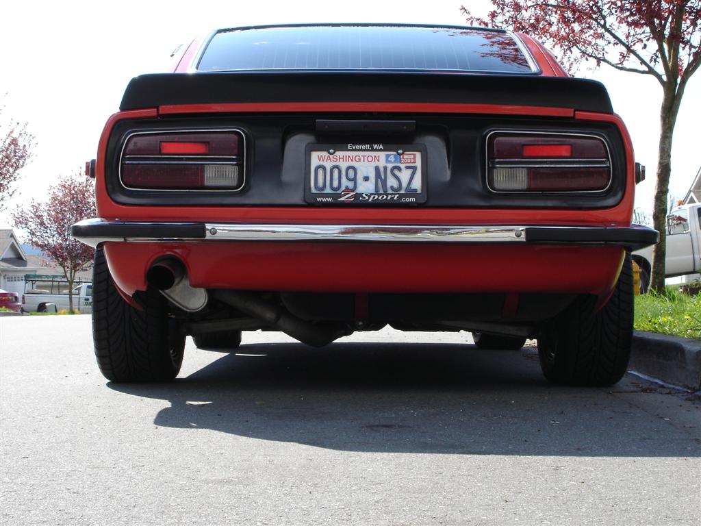

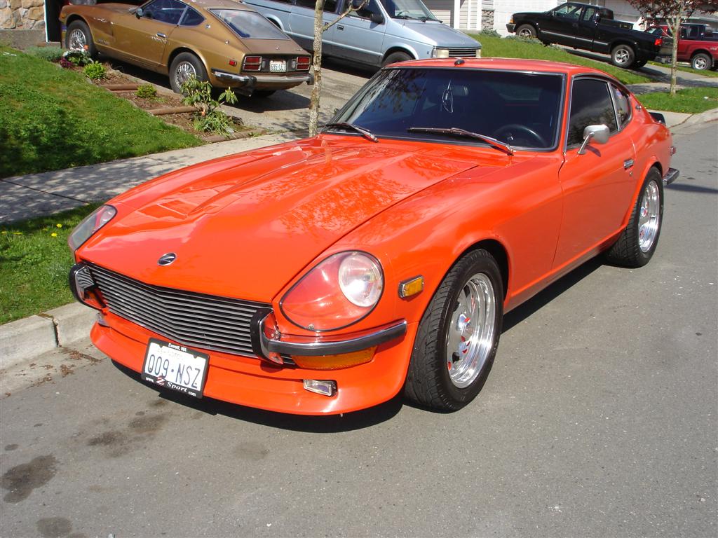

April 8, 200916 yr comment_280137 My absolute favorite has always been the 16 X 7 wheel with 225/50R16's They fill the wheel well beautifully, nice ride, not harsh on the bumps at all, wider footprint on the road for traction and best of all, LOTS of options when it comes to different tires on a 16x7 rim. Just my $.02 worth. Dave. The pics below show how it looks and fills the wells. Link to comment https://www.classiczcars.com/forums/topic/31428-proud-240z-owner/#findComment-280137 Share on other sites More sharing options...
