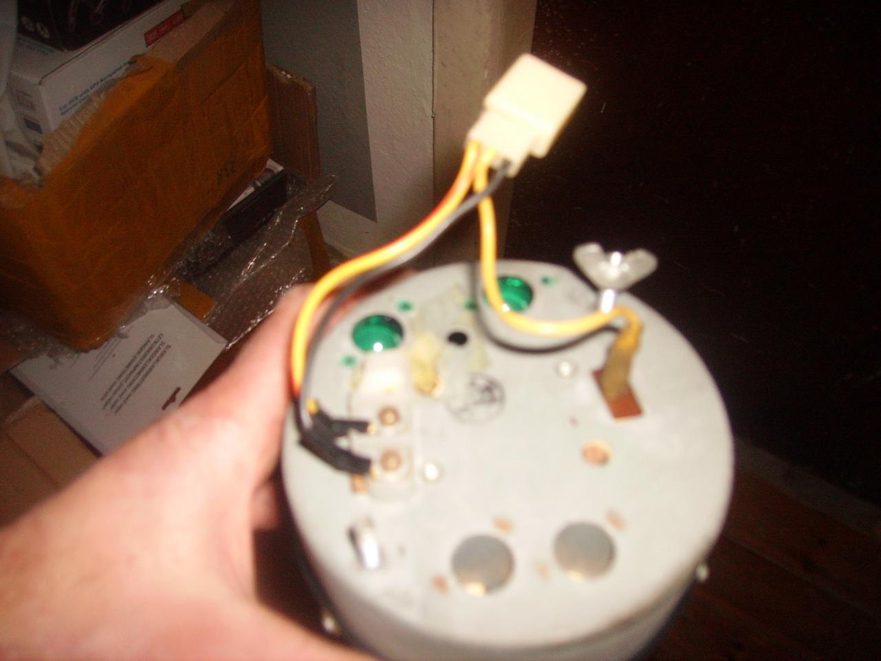

April 13, 200915 yr Author comment_280647 Come on guys 27 looks and still no answer, well forget about it, i solved it my self and for further references if anyone should have a similar problem, then just connect the male and female connectors under the stearing columm:stupid: The tach on the other hand, i have always thought that the -73 came with a four wire tach, when i pulled mine today i noticed that there only is tree wires, please look at the attached photo and confirm to me what kind it is, what makes me winder is that the connector is a 3 wire one, i can't believe that to be normal for a four wire tac, can it really be true that a PO have swapped all the dash harness ??? At the same time i wanted to install the original radio given to me by lpraun, i found then that some jeark apperently have cut the connector off of the harness, where can i get one of those ??? Chris Edited April 13, 200915 yr by ChrisZ Link to comment https://www.classiczcars.com/forums/topic/31491-lights-wont-come-on/#findComment-280647 Share on other sites More sharing options...
April 13, 200915 yr comment_280648 No, the four wire tach was the early style. Your '73 should have a three wire. Link to comment https://www.classiczcars.com/forums/topic/31491-lights-wont-come-on/#findComment-280648 Share on other sites More sharing options...
April 13, 200915 yr Author comment_280649 Arne, it makes sence, but have a look here: http://www2.zhome.com:81/ZCMnL/tech/cooper.htm and looking at the FSM wiring diagram there is also shown four wires.Chris Link to comment https://www.classiczcars.com/forums/topic/31491-lights-wont-come-on/#findComment-280649 Share on other sites More sharing options...
