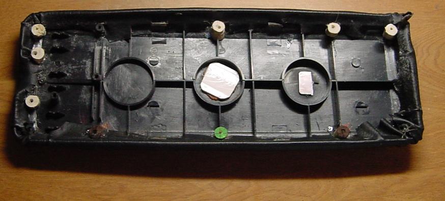

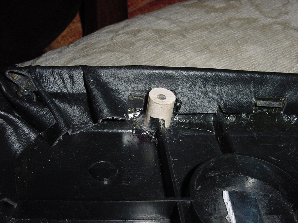

I have my lid back on as of today.
I cut off the broken bosses down to the solid part of the base or completely down to the plastic lid, then used 1/2 inch dowel to create new screw bosses, which were attached to the lid using GOOP. The dowels were drilled & tapped.
Bryan Owens (LBO730) of Brookland Trim in Bristol, VA specializes in covering things Z, and did a very nice job covering the lid with a nice vinyl that looks and feels like real leather. :love:
thxZ
The first picture of of one of the new bosses, which has a notched bottom. The second picture is the lid with more bosses in place.
