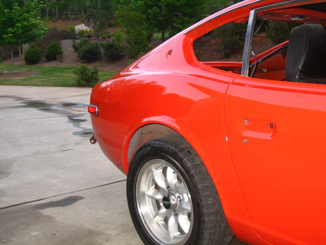

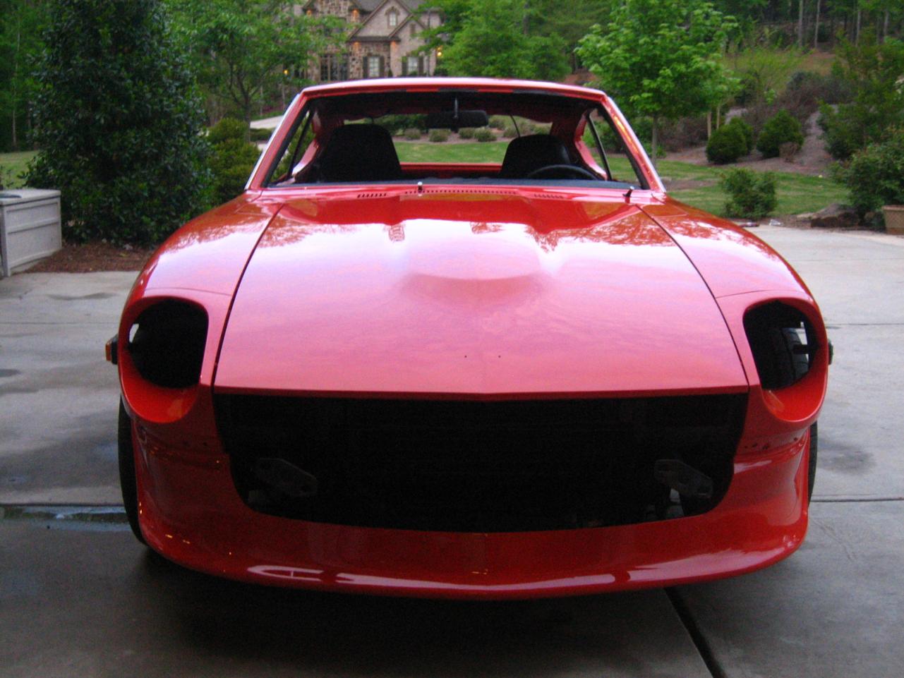

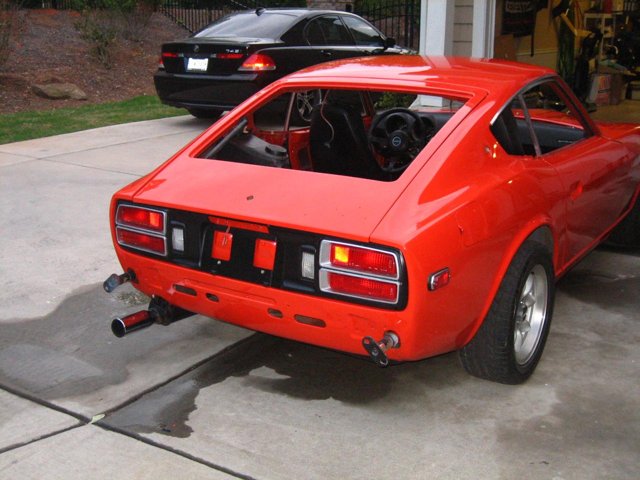

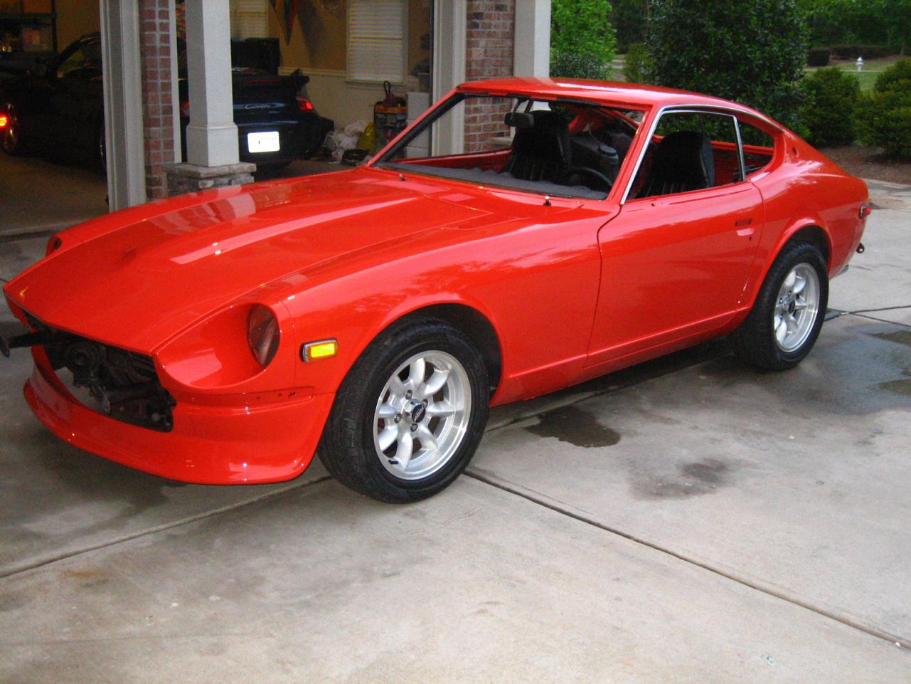

Just got it back, what a relief, awesome job. About $2,000 for the base/clear. I had all the trim, windows, bumpers etc off the car, but they did all the sanding, blocked out the doors, etc. They have a very new, hi tech shop, full modern heated booth, etc. Anyways, finish is like a mirror, looks better than the paint on my new BMW. If you need paint in Atlanta, call Brian Wozniack at Wazi Autobody in Cumming near the lake (770) 888-7455. They even picked up the car on a flatbed at my house for me. I would recommend them highly. Here's some pics:
