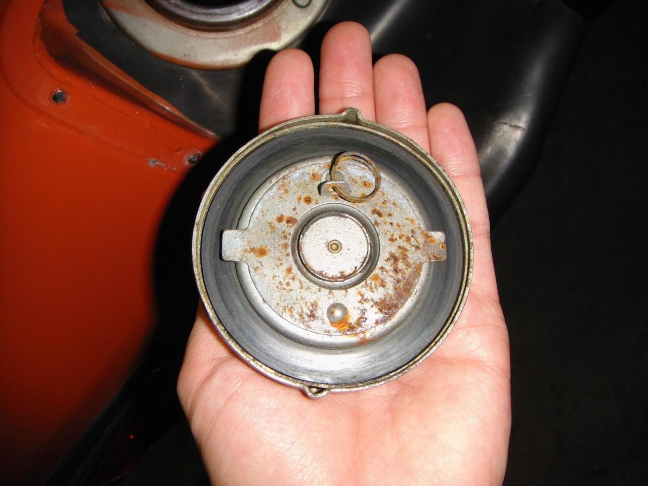

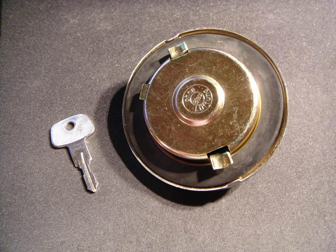

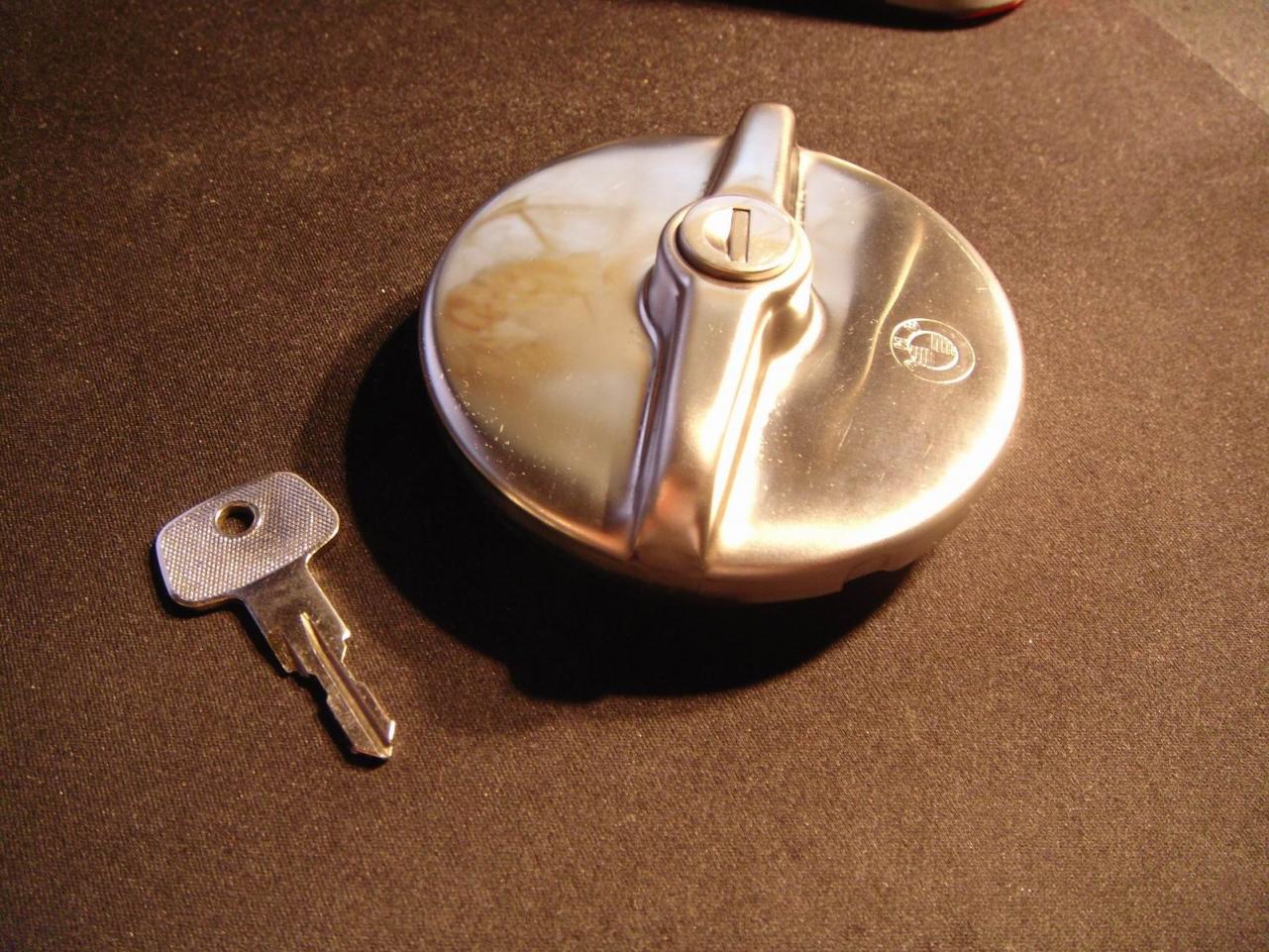

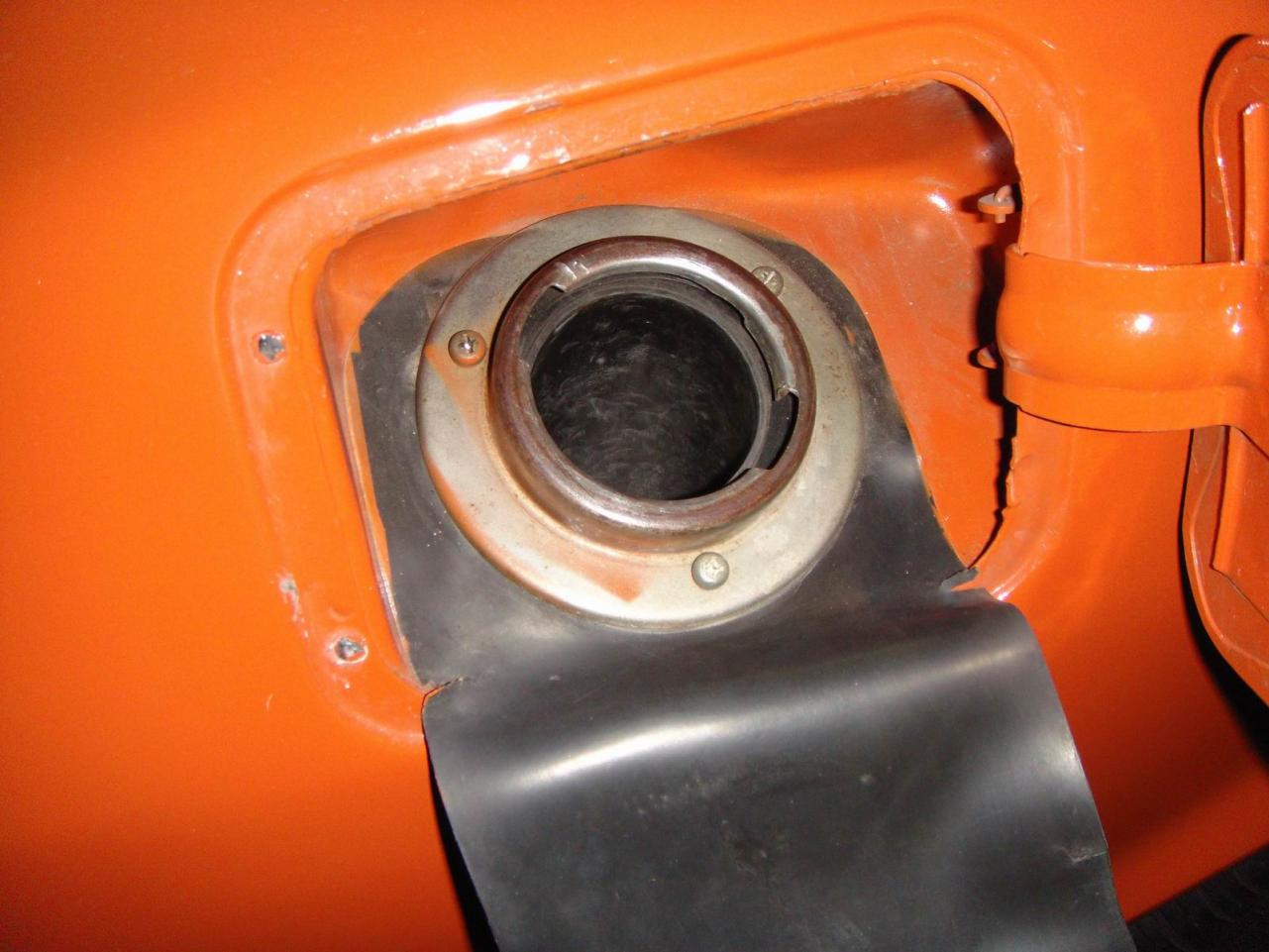

Posted April 24, 200916 yr comment_281615 Hello all, A few years back I read about this BMW locking gas cap that was alleged to be a perfect fit in our 240Zs, so I bought one for my 72. Prior to this, my car had some no-name brand locking gas cap that some previous owner had installed long ago, but the locking mechanism broke and it would no longer seal. I picked up one of these BMW caps from partstrain.com based on part numbers I found on zcar.com. I believe this swap has since been sold by MSA, as discussed here, and on the zcar.com thread linked in this thread: http://www.classiczcars.com/forums/showthread.php?t=24952 At any rate, the BMW gas cap did not fit my flange. The center section of the cap was slightly too large to fit. I instead had to go back to using this old non-locking gas cap which I was told was for a 240z, and it fits fine. My question is this, judging by these photos, does my flange appear to be some aftermarket version to fit the old aftermarket locking gas cap the car used to have? The 1st photo is the flange mounted on my car, the 2nd is the non-locking "240z" gas cap I either got from another member here, or off ebay (can't recall). The 3rd and 4th pictures are the BMW cap. I think it could be made to fit with some modification to the flange, but I would rather not do that, in case the flange may be NLA... I'm trying to find the original flange on the microfiche to see if replacements are available, but I can't tell from the illustration exactly what is what... I think it may be 17212-E4101... I would post a screenshot from the microfiche, but I believe it's against the rules? Thanks Edited April 24, 200916 yr by Inf Link to comment https://www.classiczcars.com/forums/topic/31631-bmw-locking-gas-cap-in-a-240z/ Share on other sites More sharing options...
April 24, 200916 yr comment_281621 I'm pretty sure my 2/70 filler 'flange' doesn't look like that. It's late and I can't be sure, but that looks aftermarket. Link to comment https://www.classiczcars.com/forums/topic/31631-bmw-locking-gas-cap-in-a-240z/#findComment-281621 Share on other sites More sharing options...
April 25, 200916 yr Author comment_281683 Hrmm, could someone with a 240Z do me a favor and measure the diameter of their gas flange opening? The part number I THINK it is is only 8 dollars or so at Courtesy Edited April 25, 200916 yr by Inf typo Link to comment https://www.classiczcars.com/forums/topic/31631-bmw-locking-gas-cap-in-a-240z/#findComment-281683 Share on other sites More sharing options...
April 25, 200916 yr comment_281688 Mine measures 57mm. Link to comment https://www.classiczcars.com/forums/topic/31631-bmw-locking-gas-cap-in-a-240z/#findComment-281688 Share on other sites More sharing options...
April 25, 200916 yr comment_281702 I just looked @ mine. It looks identical. My bad. Link to comment https://www.classiczcars.com/forums/topic/31631-bmw-locking-gas-cap-in-a-240z/#findComment-281702 Share on other sites More sharing options...
April 25, 200916 yr comment_281721 Inf said: Hello all,A few years back I read about this BMW locking gas cap that was alleged to be a perfect fit in our 240Zs, so I bought one for my 72. Prior to this, my car had some no-name brand locking gas cap that some previous owner had installed long ago, but the locking mechanism broke and it would no longer seal. I picked up one of these BMW caps from partstrain.com based on part numbers I found on zcar.com.I believe this swap has since been sold by MSA, as discussed here, and on the zcar.com thread linked in this thread:http://www.classiczcars.com/forums/showthread.php?t=24952At any rate, the BMW gas cap did not fit my flange. The center section of the cap was slightly too large to fit. I instead had to go back to using this old non-locking gas cap which I was told was for a 240z, and it fits fine. My question is this, judging by these photos, does my flange appear to be some aftermarket version to fit the old aftermarket locking gas cap the car used to have?The 1st photo is the flange mounted on my car, the 2nd is the non-locking "240z" gas cap I either got from another member here, or off ebay (can't recall). The 3rd and 4th pictures are the BMW cap. I think it could be made to fit with some modification to the flange, but I would rather not do that, in case the flange may be NLA...I'm trying to find the original flange on the microfiche to see if replacements are available, but I can't tell from the illustration exactly what is what... I think it may be 17212-E4101... I would post a screenshot from the microfiche, but I believe it's against the rules?ThanksMy gas flange looks like yours as well and that nice looking BMW cap I purchased did not fit either. :mad: Link to comment https://www.classiczcars.com/forums/topic/31631-bmw-locking-gas-cap-in-a-240z/#findComment-281721 Share on other sites More sharing options...
April 25, 200916 yr comment_281723 Looks to me like that cap might fit a 260Z or an early 280Z (the one's with the larger diameter filler neck) but I don't see it fitting anything else.....except maybe a BMW:) Well, the story did originate on zcar.com. It certainly wouldn't be the first questionable thing to come from there. Edited April 25, 200916 yr by sblake01 Link to comment https://www.classiczcars.com/forums/topic/31631-bmw-locking-gas-cap-in-a-240z/#findComment-281723 Share on other sites More sharing options...
April 25, 200916 yr Author comment_281736 Bummer. I haven't heard anything bad about the BMW cap MSA was selling, so I can only assume the zcar.com thread had the wrong part number. MSA no longer sells it, so I can probably assume the supply "dried up" under the demand from z-car owners. Also, thanks MikeW. I measured mine and it's the same. 57mm is about 2.25", and the center section of this BMW cap seems to be a good 1/16" larger than that. Edited April 25, 200916 yr by Inf Link to comment https://www.classiczcars.com/forums/topic/31631-bmw-locking-gas-cap-in-a-240z/#findComment-281736 Share on other sites More sharing options...
May 10, 200915 yr comment_283275 I have the same BMW cap on my 70 240Z. In order for me to make it work I had to use tin snips and cut a tiny bit off each of the latches that extend out on the cap. It fits fine now, but the downside is you can't lock it. The lock works on the cap but you can still unscrew it and remove the cap with it "locked".Some guy on e-bay was selling the cap saying it fits a 240z and works fine.I guess it makes a good decoy. People will just assume that it is locked and not steal my gas. hahaha Link to comment https://www.classiczcars.com/forums/topic/31631-bmw-locking-gas-cap-in-a-240z/#findComment-283275 Share on other sites More sharing options...
