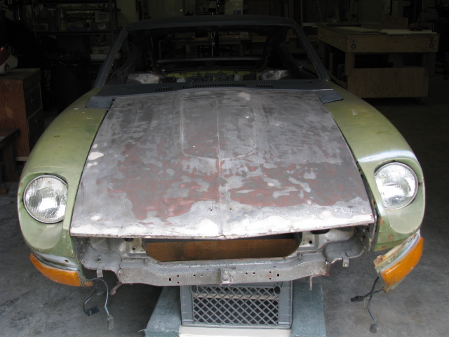

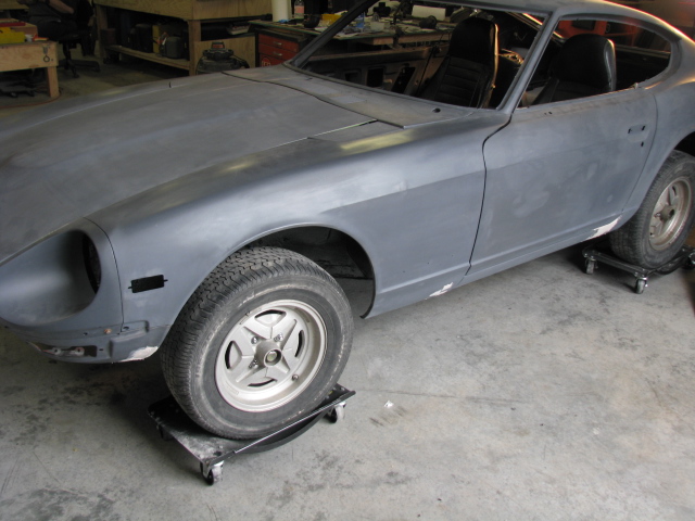

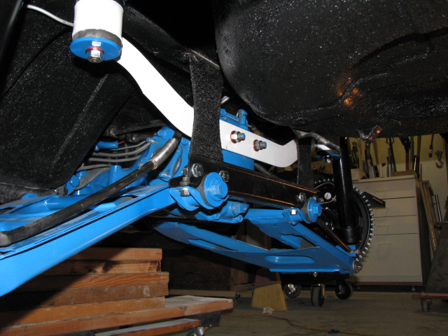

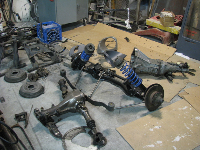

So I have been working on this z for about six months. It's a work in progress and is getting put together. When I got it it was stripped all the way down and had been soda blasted. So me and my dad have been sand blasting all the parts, painting them, and putting them on the car. You can see my blog at zrestoration.blogspot.com.
