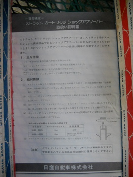

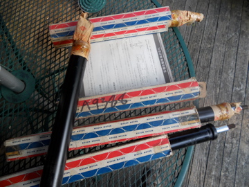

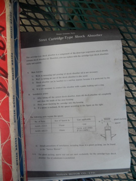

Part #'s 56205-E4125 & 56105-N3785
I don't know which is front set or rear set.
Instructions in English and Japanese
