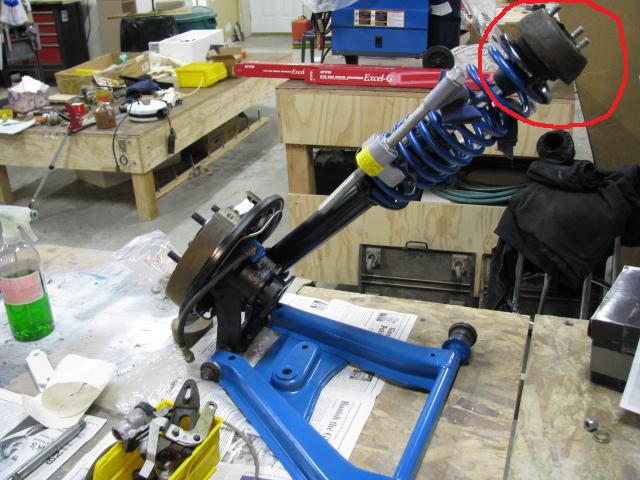

Posted April 28, 200915 yr comment_281943 Where the spring seat on the rear suspension is located, is there supposed to be any kind of rubber insert (or otherwise) in the inside portion of the "hat" (for lack of a better term) on the upper spring seat? Or does it just simply sit on top of the spring and then the rubber spacer on top of it, and finally the upper isolator? Sorry I don't have a pic at the moment. Link to comment https://www.classiczcars.com/forums/topic/31669-question-about-the-spring-seat-strut-related/ Share on other sites More sharing options...
April 28, 200915 yr Author comment_281946 I suppose what i'm trying to say is, on the shock shaft at the top is there anything around it other than a bumpestop? Link to comment https://www.classiczcars.com/forums/topic/31669-question-about-the-spring-seat-strut-related/#findComment-281946 Share on other sites More sharing options...
April 28, 200915 yr comment_281947 Hey LowCarbZ, I circled in red in the pic what I think you are asking about. There is nothing that goes on top of that, if that's what your asking. Link to comment https://www.classiczcars.com/forums/topic/31669-question-about-the-spring-seat-strut-related/#findComment-281947 Share on other sites More sharing options...

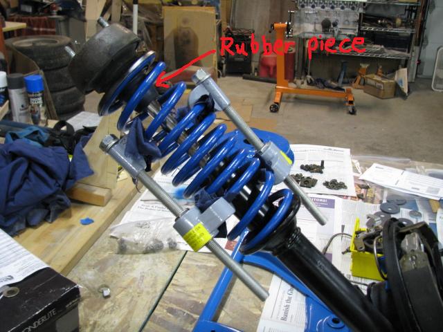

April 28, 200915 yr Author comment_281951 Here I found a pic online that I will try to use as an explanation and then put my MSPaint Skills to the test (wondering if anything goes within the red circle (on the shock shaft that sits up into the "hat" portion of the seat retainer) or if it's JUST the spring seat that sits on top of the coil with nothing within it?): Edited April 28, 200915 yr by LowCarbZ Link to comment https://www.classiczcars.com/forums/topic/31669-question-about-the-spring-seat-strut-related/#findComment-281951 Share on other sites More sharing options...
April 28, 200915 yr comment_281953 Oh I see what you mean. Yes there is a rubber spacer that goes under the spring seat. Here is another pic pointing at it. Link to comment https://www.classiczcars.com/forums/topic/31669-question-about-the-spring-seat-strut-related/#findComment-281953 Share on other sites More sharing options...
April 28, 200915 yr comment_281955 oops... here's the pic Link to comment https://www.classiczcars.com/forums/topic/31669-question-about-the-spring-seat-strut-related/#findComment-281955 Share on other sites More sharing options...
April 28, 200915 yr Author comment_281956 So it's just a bumpstop then? Reason I ask is my rear shocks were shot and bottoming out. They'd leaked right out. So upon dis-assembling my rear strut assemblies I discovered a compacted dirt up the inner portion of the spring seat "retainer". I was unsure if it was just a greasy dirt or disintegrated rubber of some sort. It wasn't overly identifiable at all. My rear shocks had no bumpstops on them either. (Unless they blew apart and are no longer identifiable or on there.) The good news is I am replacing the shocks with Original Z Koni Reds. But get this: I pulled the old shocks out and they are too in fact the EXACT same part number of Koni Reds. I guess i'll have to rebuild them as a spare set. And thank you. I appreciate your quick responses and effort. It's very helpful. Edited April 28, 200915 yr by LowCarbZ Link to comment https://www.classiczcars.com/forums/topic/31669-question-about-the-spring-seat-strut-related/#findComment-281956 Share on other sites More sharing options...

April 28, 200915 yr comment_281960 But yeah... it's just a bumpstop. Link to comment https://www.classiczcars.com/forums/topic/31669-question-about-the-spring-seat-strut-related/#findComment-281960 Share on other sites More sharing options...
