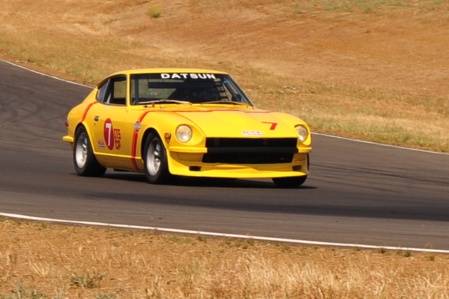

Last weekend at Thunderhill, the car ran a 2:06 flat, less that .5 seconds off a lap record which had been set by an E36 BMW that can't even run in that configuration any more without being bumped a class. Not bad after a four year layoff and the car has even more in it.
