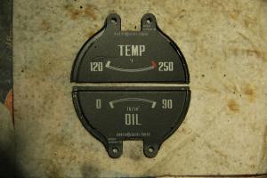

I restored my dash and noticed the glove compartment lock is chrome not concaved versus to stainless.

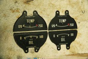

The Temp and Oil guage plates have different graphics and larger in size comparison to later year overlapped over the early one.

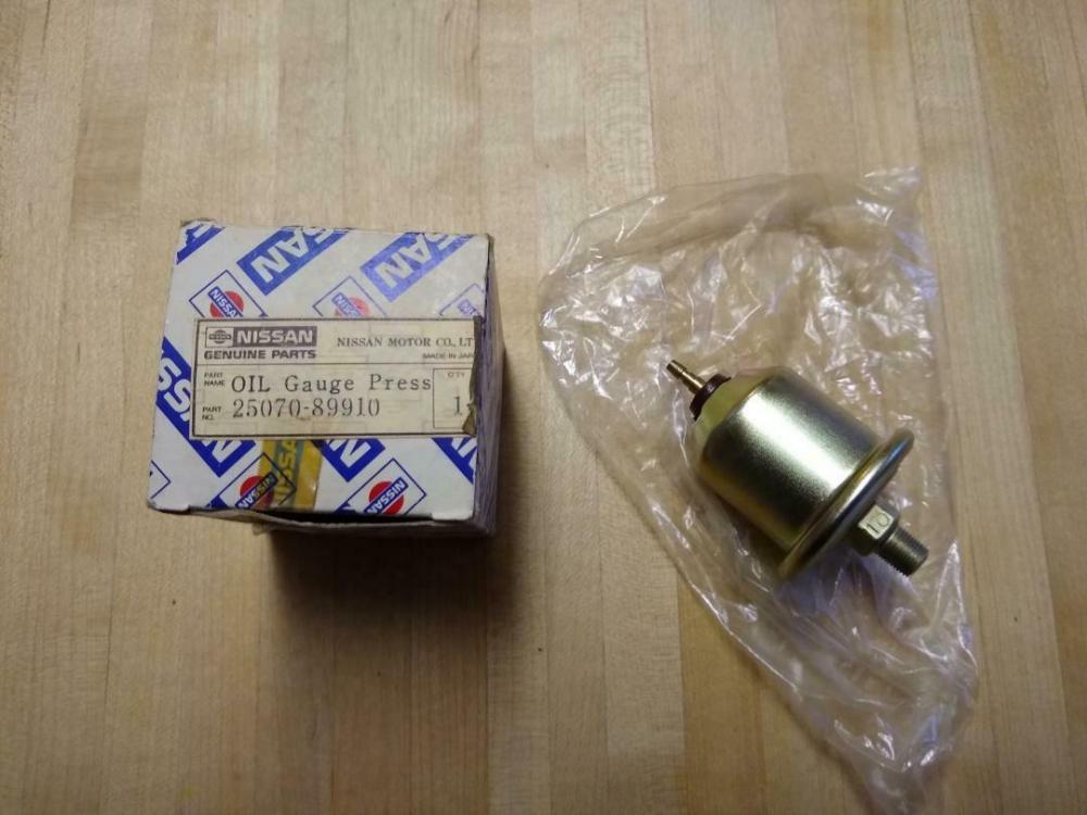

Previous to HLS30-21001, all Z-cars were shipped with an oil-pressure gauge that indicated up to 140 psi. Because the L24 was designed for less than 60 psi, Datsun had received many complaints of low oil pressure from owners, myself included. A gauge that showed a larger proportion of needle sweep for the normal pressure made sense, so a 90 psi gauge was substituted, beginning with late 240Zs.
The lower-reading gauge required a different sender. A 6kg unit supplanted the previous 10kg one. These had to be compatible; a mismatch would give an incaccurate reading so they were only interchangeable as a pair. No change was specified for the water-temperature part of this combination gauge. Parts numbers are:
New Part:
Gauge: 90 psi
24830-E8300
or 24830-E8301
Sender switch:
6kg
25070-89900
or 25070-89900
Old Part:
"Gauge: 140 psi
24830-E4400
Sender switch:
10kg
25070-89910
Datsun didn't intend to stock the early 10kg sender after dealer supplies ran out, so if you have to replace yours on an early 240Z, carefully check part numbers. You may need to change your gauge if the 25070-89910 sender switch isn't available. The later gauge is otherwise indentical with the original type.
Hope this explanation helps.
Dan
Thanks Dan,
I was wondering why the oil pressure read so high on 249!  I found the original sensor in a parts bit that came with the car so I will install it.
