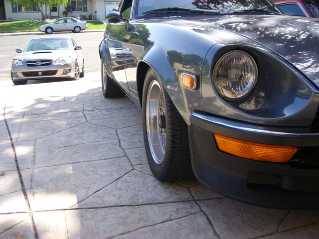

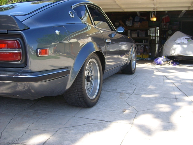

Hi Everyone,
Its been a while since I have posted here, but with the recent painting of my 71 24z, I have renewed enthusiasm. One thing I would like to do is to get tires which fill out the fender wells a little more, particularly in the rears. I like the look of the existing wheels (15 x 7 +10) and don't feel a pressing need to replace them. The 225/50-15 tires are pretty old/cracked and really need to be replaced. One solution I am considering is to replace the tires with the same size , but add 1/2" - 3/4" spacers in the rear. A friend of mine suggests going with a taller tires like 205/55-15 to be more period appropriate and fill out the fender wells some.

I'm onboard with both ideas – spacers to fill the flares, and taller sidewalls for the period look. But 205/55-15 isn't measurably taller than the 225/50-15, just narrower.
Considering the stance of the car, I'd think about staying with 225/50 on the front, and 225/55 on the rear, except the 225/55-15 size is damn rare these days. That being the case, the only way you're going to get taller is to go narrower. Perhaps 205/55-15 front, and 215/60-15 rear.

There are so many options and taste to consider. Price also plays a part in your decision. Although the selection of good 225/50-15 tires are getting scarce. If you use a spacer just don't forget to periodically retorque the spacer (it is so easy to forget because it is behind the wheel). I prefer to use a wider wheel, but that cost more money. Wheels are always a very subjective subject.

By the way, larger wheels do not fill out a wheel well if the rolling diameter is the same.
thanks everyone for the all the input. I will probably go teh spacer route and continue with the 225/50-15 tires. I have also thought about 16" or 17 " wheel and wider tires too but for several reason this is not a good solution now. One of my concerns here is that the car was lowered by one of the previous owners by cutting the springs ad with the new flares I have no idea how tire I run without rubbing. The car's steering is also very heavy heavy and adding more tire will make worse (my wife's complaint). Thirdly, I just dropped a bunch $$$ into the paint and body work and I don't really want to fork out the cash for new tires an wheels ( once again the wife factor).
I have been looking for 20mm spacers on Ebay. I know I need 4 x 114.3. Does any know if the 4 bolt spacers for a 240sx will work?
