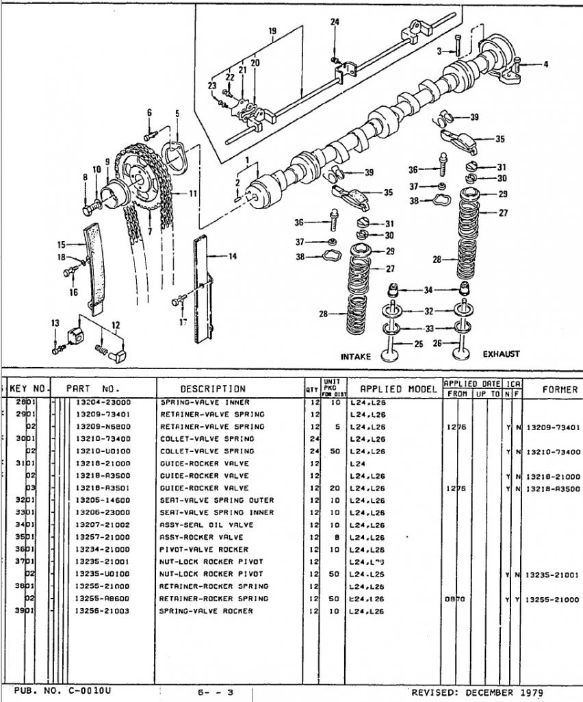

May 16, 200915 yr Author comment_283879 Here are the pictures. Take a look at the cylinder head, it seems to be a part out of place (dont know the name of this part I beleive is lash pad spring retainer, and dont think is to much problem to fix). Edited May 16, 200915 yr by Panamared Link to comment https://www.classiczcars.com/forums/topic/31878-sus-and-e31-head/#findComment-283879 Share on other sites More sharing options...

May 18, 200915 yr comment_284067 Panamared said: Here are the pictures.Take a look at the cylinder head, it seems to be a part out of place (dont know the name of this part I beleive is lash pad spring retainer, and dont think is to much problem to fix). Retainer-Rocker Spring See attached... #38 In the picture it seems to be, in the place it is supposed to be in. FWIW, Carl B. Link to comment https://www.classiczcars.com/forums/topic/31878-sus-and-e31-head/#findComment-284067 Share on other sites More sharing options...

May 20, 200915 yr Author comment_284236 Hi guys, Thank You for your help. Carl. That is the right part and it is in the right place but the end of the retainer if you look close is not under the nut.Dave.. Thank you for the pictures. Those carbs looks awesome. Im cleaning them first to continue with the polishing.Any help would be super.You guys rule. Link to comment https://www.classiczcars.com/forums/topic/31878-sus-and-e31-head/#findComment-284236 Share on other sites More sharing options...

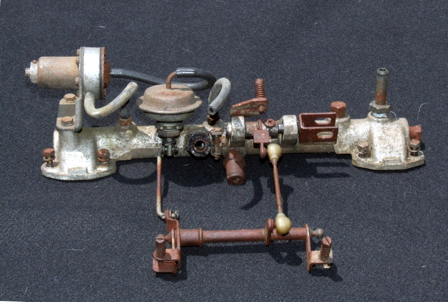

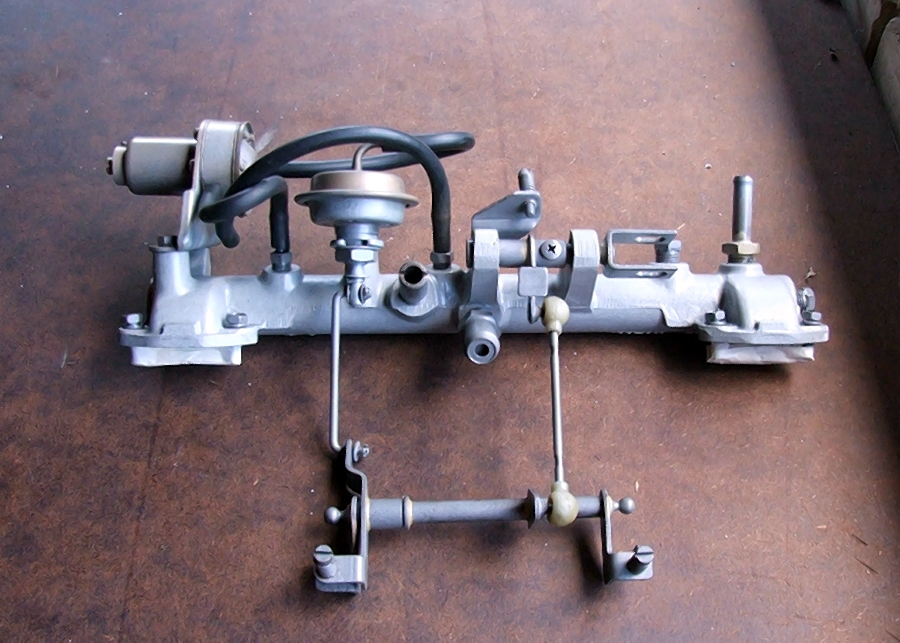

May 21, 200915 yr comment_284262 I agree with Dave about media blasting some parts with glass beads. It's quick and gives results that are pleasing to the eyes. For the domes and bodies, I'd hand polish Example: Before (pretty much a basket case): After glass beading: Edited May 21, 200915 yr by DeesZ Link to comment https://www.classiczcars.com/forums/topic/31878-sus-and-e31-head/#findComment-284262 Share on other sites More sharing options...
