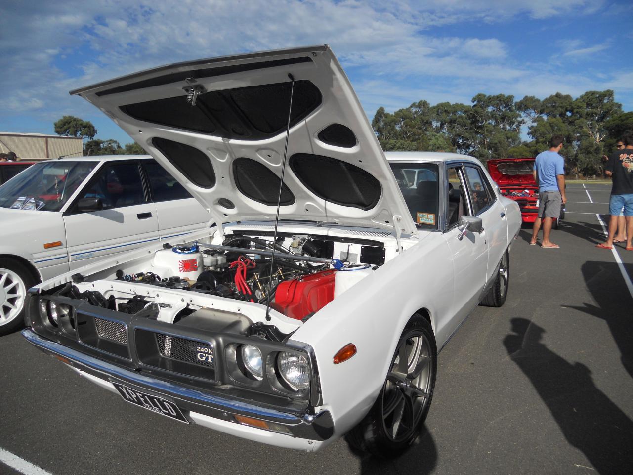

The motor that's in at the moment is a rb25...currently building a new rb25 motor with series 1 rb25 head with neo lifters, head chambers oversized to 56cc, rb26 crank, rods and pistons...and keeping the VCT.....kinda thought that the stock off the boat import motor would have **** itself by now, but it hasn't.........250kilowats at the rear on 9psi.......(I used the rb25 engine configuration because I didn't think that the rb26 manifold and r33-24 brake booster would fit under the engine bay, and also the inlet side of the manifold kinda goes through the battery) Changed the covers when I installed the high mount, but I'm just still waiting for the big bang!
