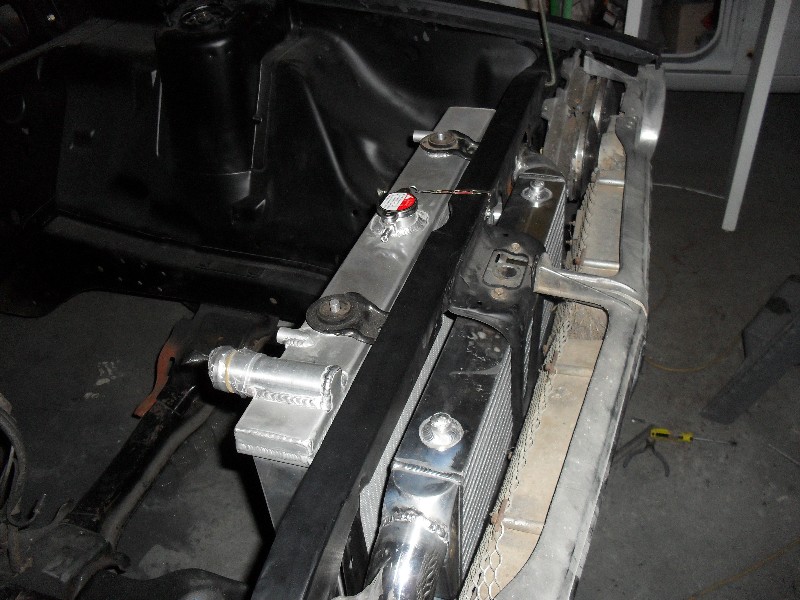

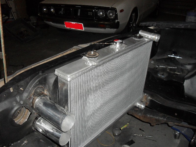

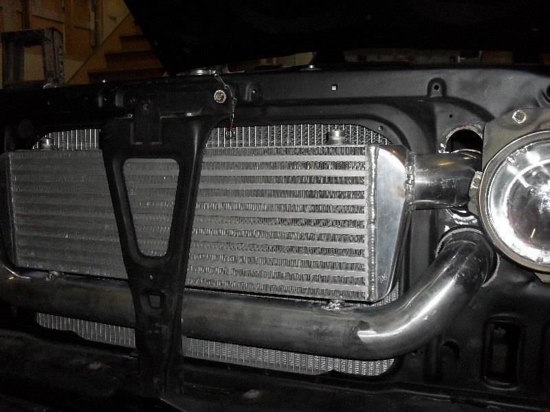

July 22, 200915 yr Author comment_290137 Fabricated intercooler piping over the weekend, had to cut a small section off the top of the rails to make room for the r33 radiator, but it all seems to fit ok... Link to comment https://www.classiczcars.com/forums/topic/31880-operation-240k/?&page=3#findComment-290137 Share on other sites More sharing options...
