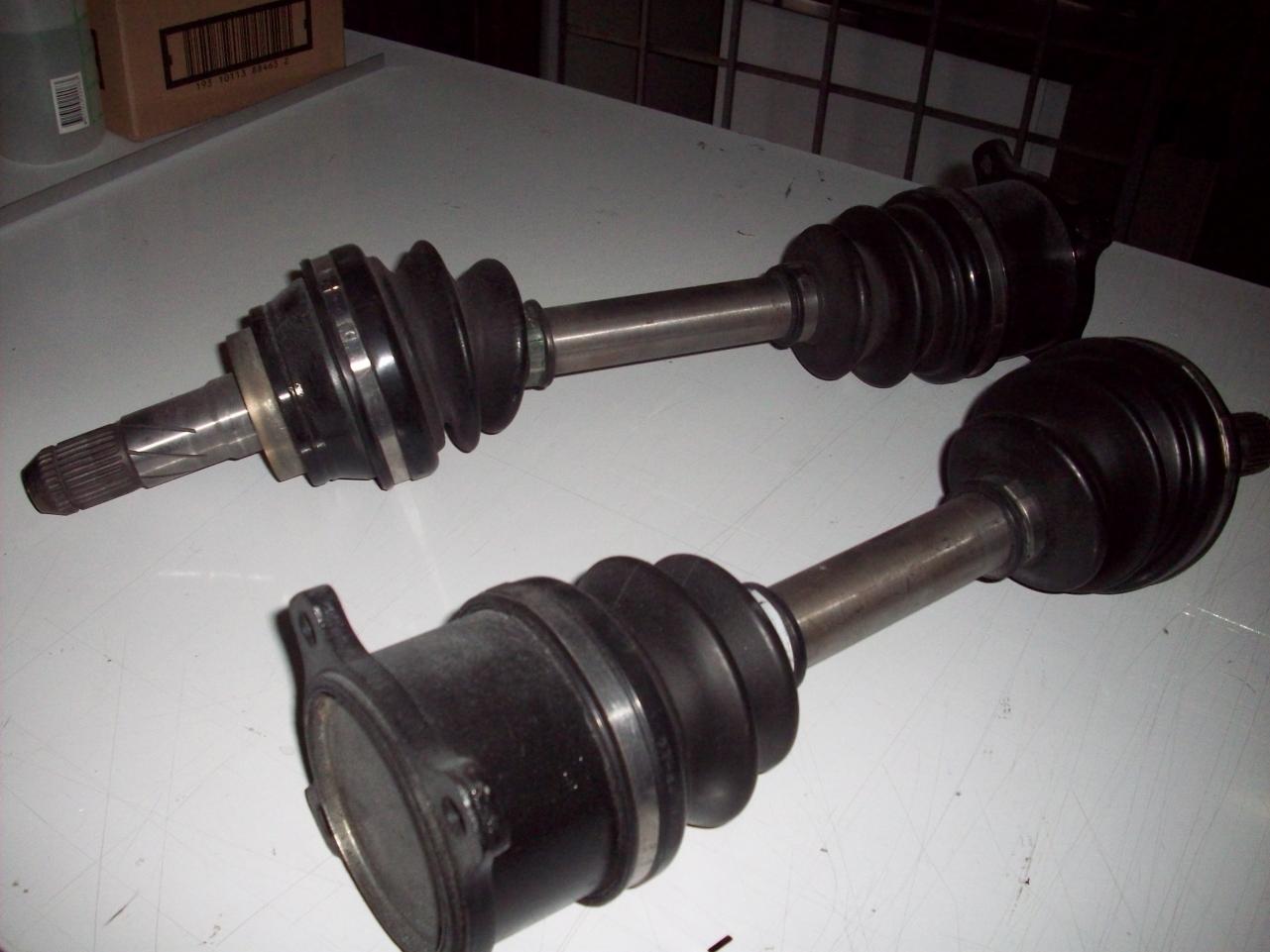

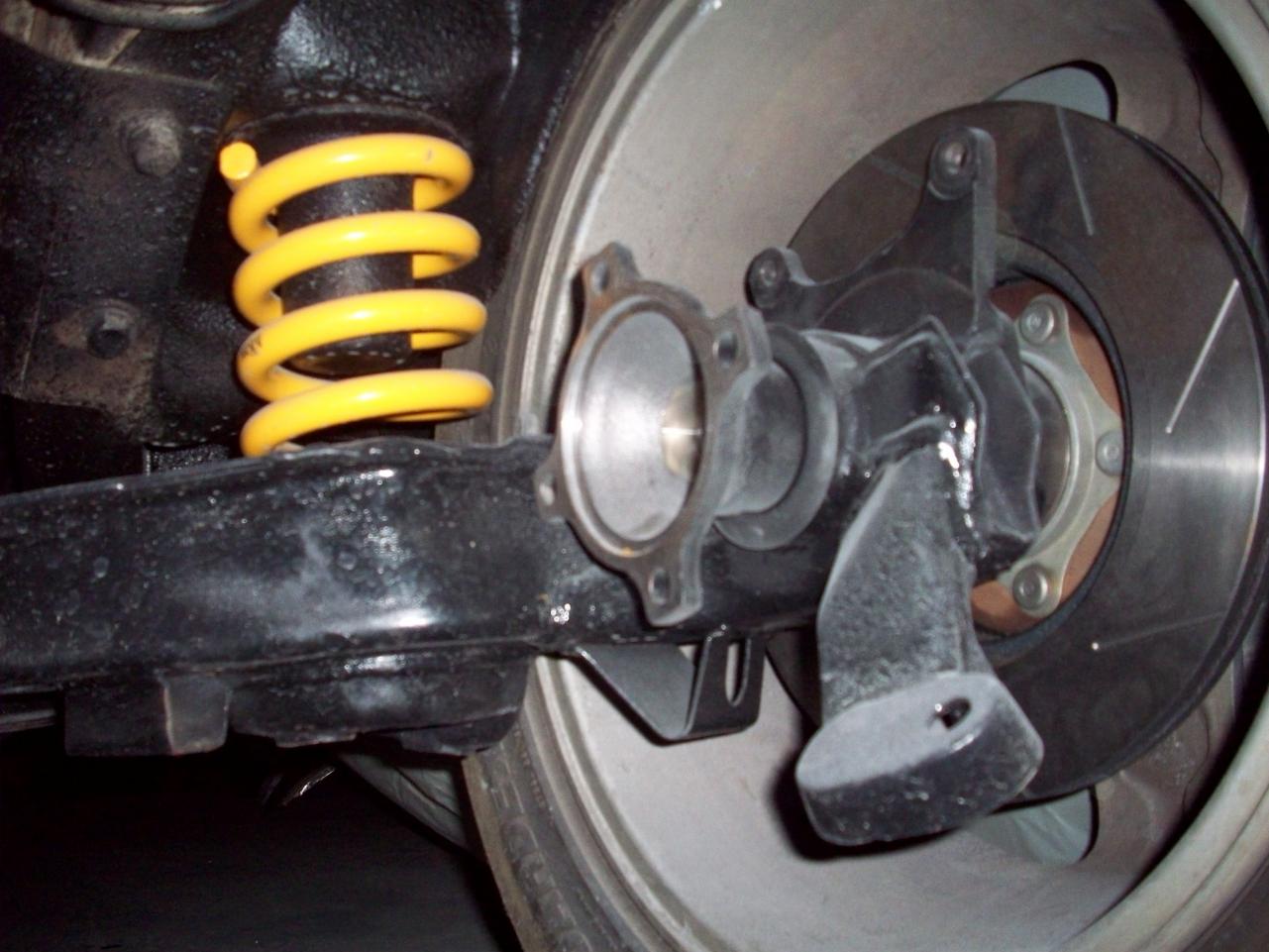

Some shots of the rear cv conversion before it gets bolted together. I used z31 turbo 5 bolt rear hubs, flanges, and half shafts, (the shafts themselves were fabricated for me by an engineer in bayswater, cost around $400)......The z31 rear flanges are much bigger than the standard 240k flanges, so the A frames also have to modified, so does the lower mounting plate for the shocker ( which now seems to fit better than standard)

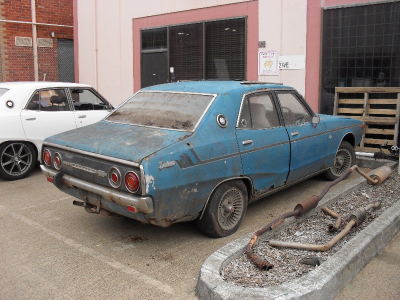

No good mate,
Thats a shame if I knew you had it I would have asked for some parts as I am building a 4 door and desperately need the trims around the rear lights and a rear bar. Damn for you and damn for me!!
PS some serious rust in the old girl.
