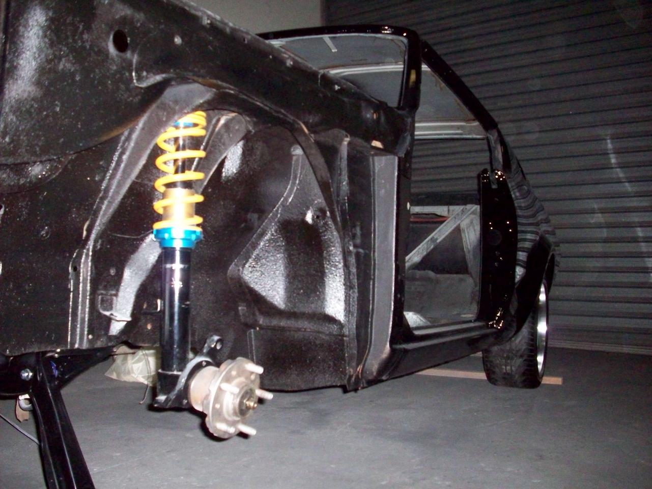

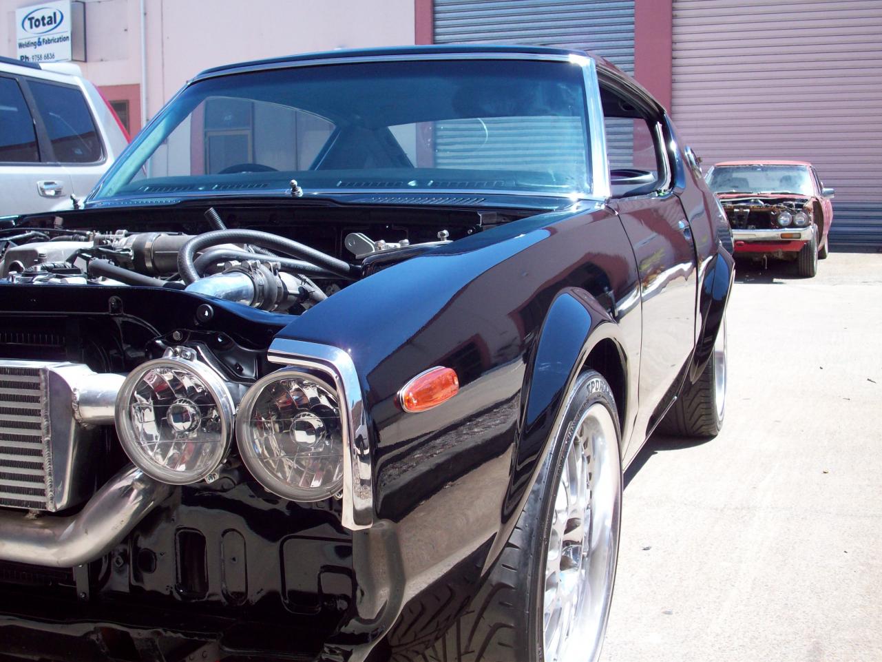

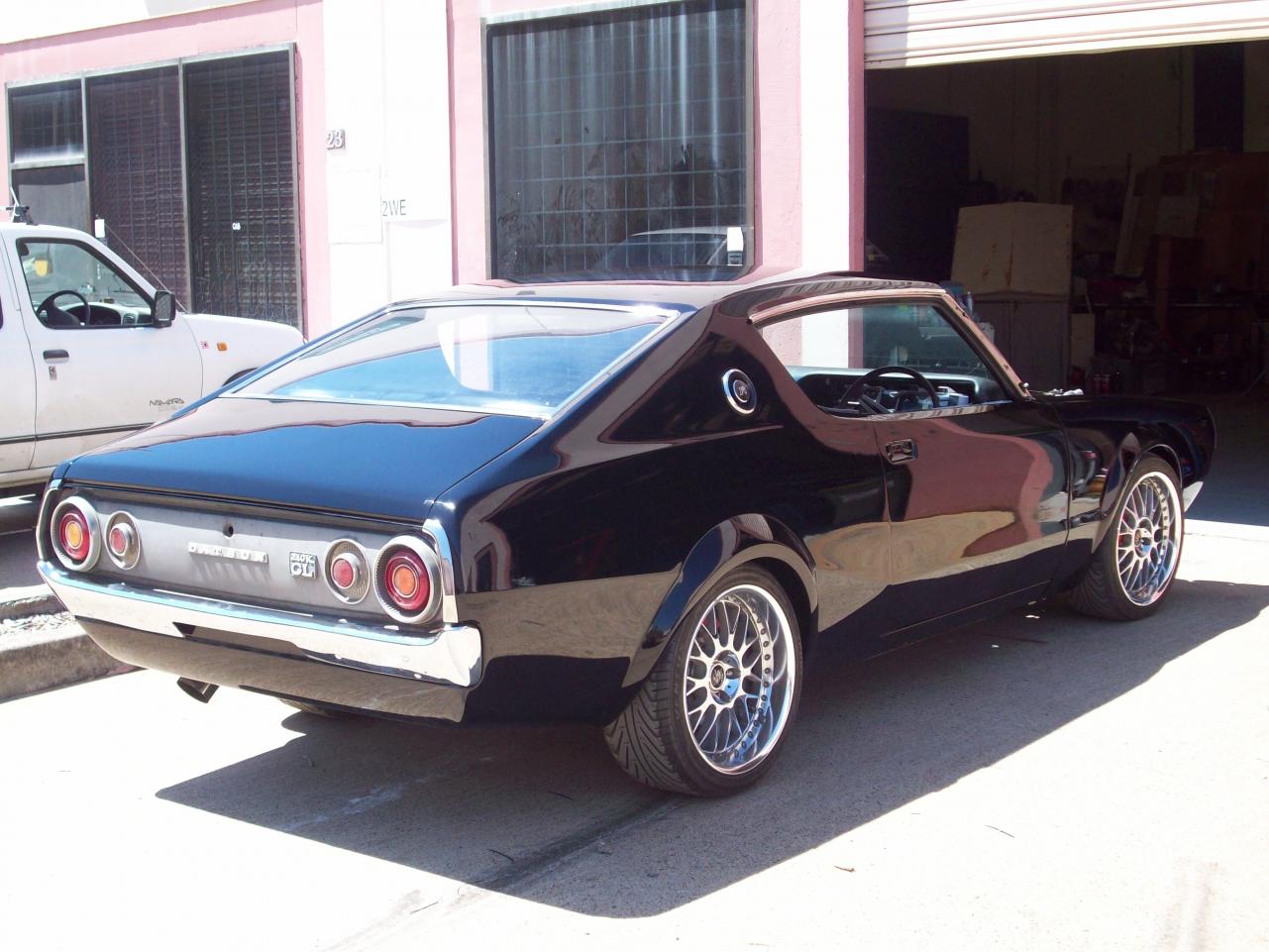

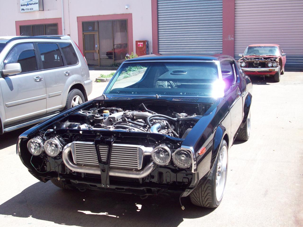

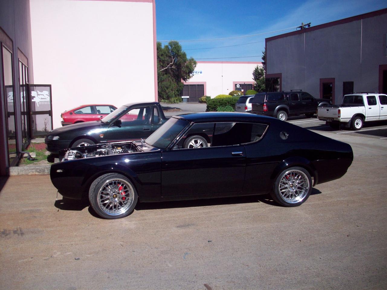

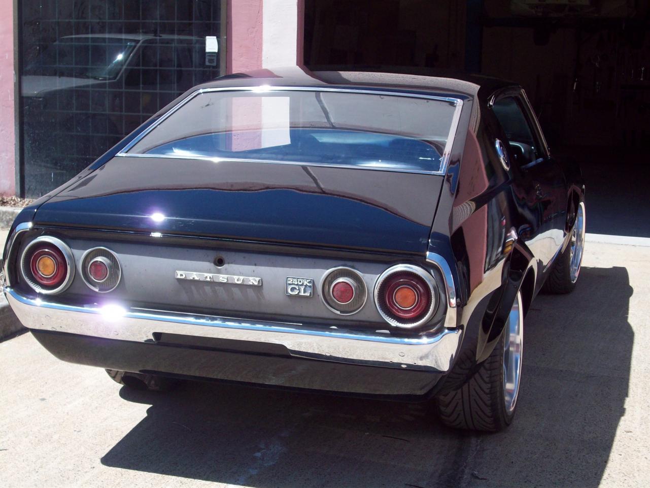

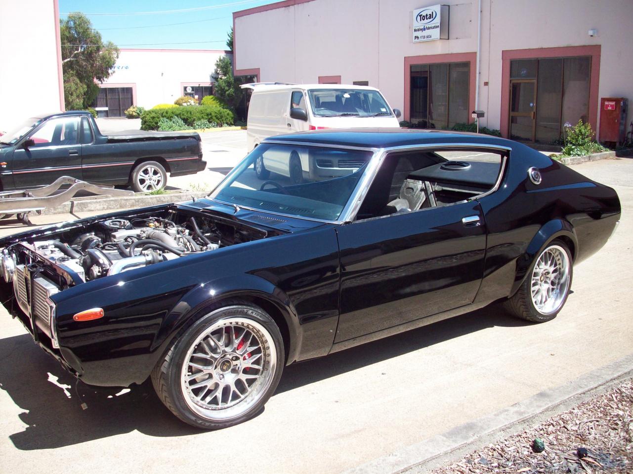

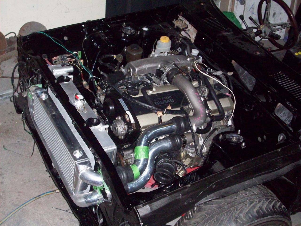

Hi everyone, Wondering if anyone is interested but Operation K is underway. Our project starts off with a coupe shell that i salvaged from the crusher which cost me $350 a tonne. It spent the last 3 months having all the rust cut out of it which includes lower rear quarters front and back, rear beaver panel, lower door skins, lower guard skins, roof gutters in and out and steel GT-R guards. The photos show some of the steel work that we've completed.

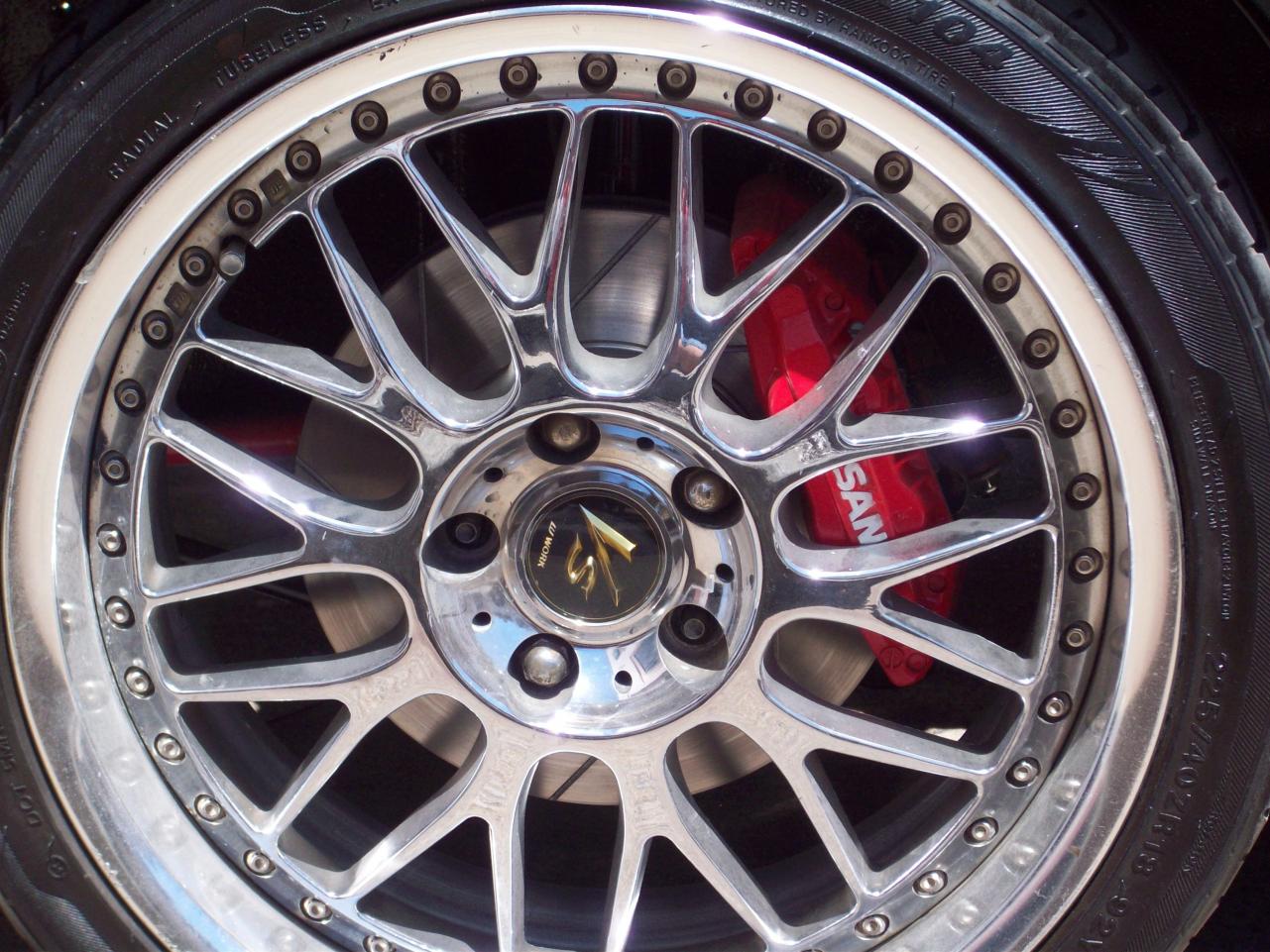

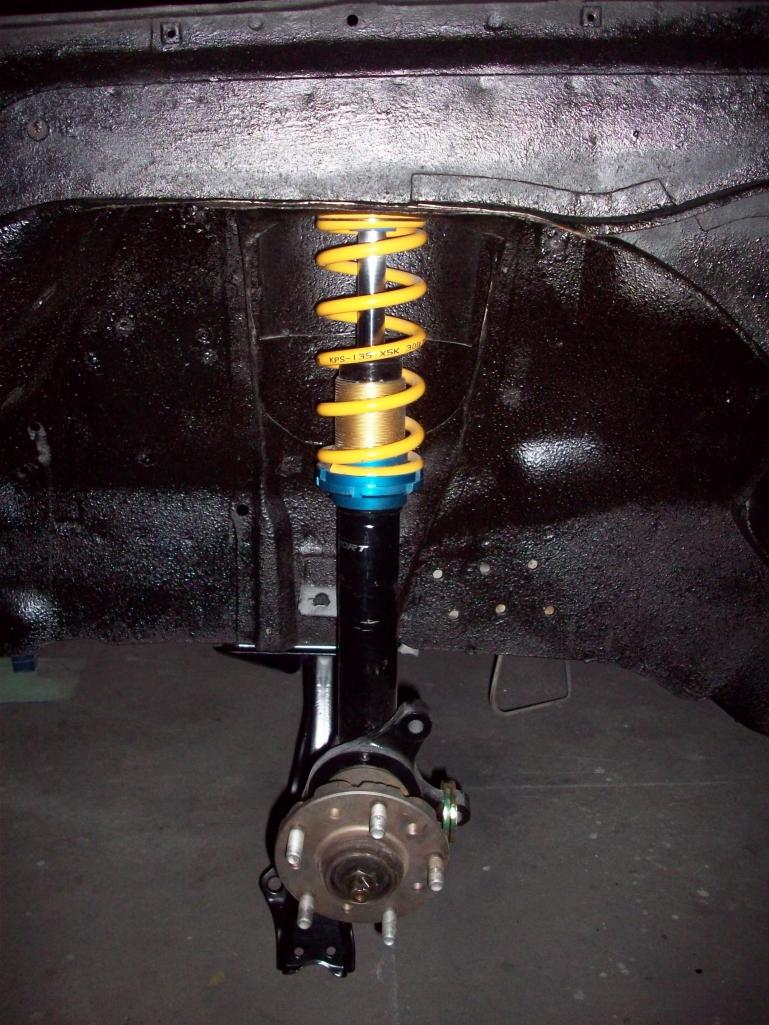

I've decided to install an RB25det with matching gearbox, and r200 diff centre with cv rather than the uni's. R32 rotors with the quad spots upfront and California vented rears and calipers up back, all sitting on z31, 5 stud hubs.
Most of the fabrication is completed and i will post more shots if anyone is interested...
