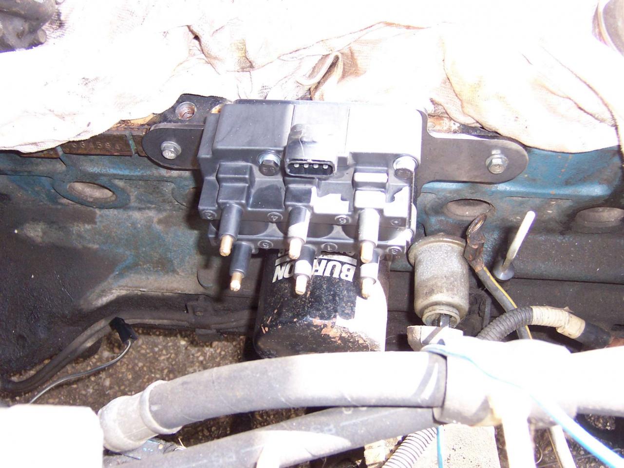

I'm thinking the XM will be an original restore, back to super pursit standards. Dave's putting the newest sedan together at the moment and I'm working on a disc barke conversion (front and back) for the sedan and trying to get my original tacho to work in the coupe (six coils is a bitch). Then we'll start chasing XM parts, It should be a much easier restore than the K's, I know you can buy almost everything new or repo......and not have to make it...

Have you tried something like this, you will have to add some more diodes
This is what I'm using for my EDIS (waste spark), to make my original 240K tacho work
