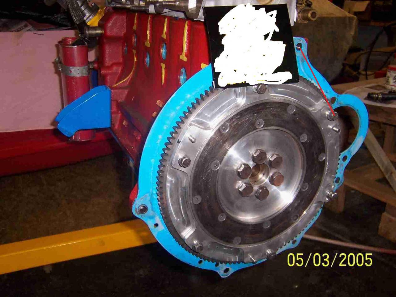

May 18, 200915 yr comment_284093 Here is what I do to get the flywheel loose. Once the clutch is off use a piece of metal with 2 holes and place it where the red line is hand tighten the bolts back up.Then remove the center flywheel bolts. The piece of metal will stop the flywheel from turning. This way is easy and quick. P.S. Pic used from the net. Link to comment https://www.classiczcars.com/forums/topic/31898-how-to-remove-the-flywheel/#findComment-284093 Share on other sites More sharing options...

May 19, 200915 yr comment_284118 I just used a 6 point socket on a breaker bar and a 3 lb. dead blow hammer. Engine compression was enough resistance on the flywheel with the impact. All bolts came out fine without and scarring of the heads. Link to comment https://www.classiczcars.com/forums/topic/31898-how-to-remove-the-flywheel/#findComment-284118 Share on other sites More sharing options...

May 19, 200915 yr Author comment_284126 Thanks! Seems like the impact wrench (air ratchet) is the way to go. I've also heard re-inserting one of the tranny bolts and using a prybar into the teeth of the flywheel will keep the motor from turning. I will try that first before I purchase the impact wrench. I am also faced with a replacement tranny that has a stripped out drain plug (!) which may be solved with the impact ratchet as well. May have to make a trip to Harbor Freight.Thanks again!---Chris Link to comment https://www.classiczcars.com/forums/topic/31898-how-to-remove-the-flywheel/#findComment-284126 Share on other sites More sharing options...
