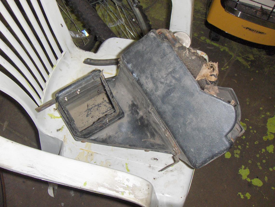

May 21, 200915 yr comment_284284 Okay, here is the scoop. In the attached picture the "outlet" of the evaporator is the small square opening on the left. The top lever of the heater control panel is marked with three positions: OFF/VENT/HEAT In the OFF position, the fan pulls air from INSIDE the car, near the passenger floorboard. (Passenger on a LHD car...) The evaporator housing's outlet mates up to the inlet of the inside air intake, thus you have to run the air conditioner with the top lever in the OFF position, or it does not work. Thus the aftermarket air conditioner didn't require cutting any holes in the fan housing during installation, and there are no holes to plug when you remove it! I knew it was something like that but my advancing "sometimers" got in the way. Link to comment https://www.classiczcars.com/forums/topic/31919-removing-air-conditioning/#findComment-284284 Share on other sites More sharing options...
May 21, 200915 yr comment_284300 I guess there were different aftermarket units. This one appears to require an opening were it mates with the blower housing. Link to comment https://www.classiczcars.com/forums/topic/31919-removing-air-conditioning/#findComment-284300 Share on other sites More sharing options...
