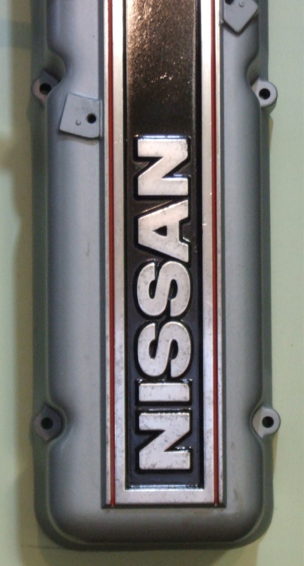

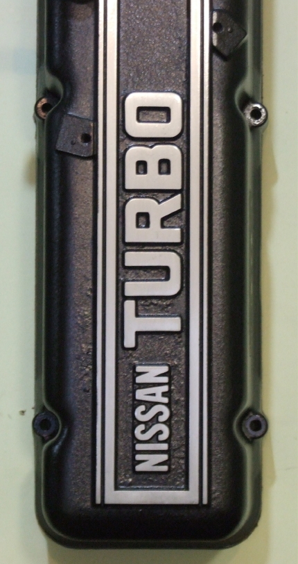

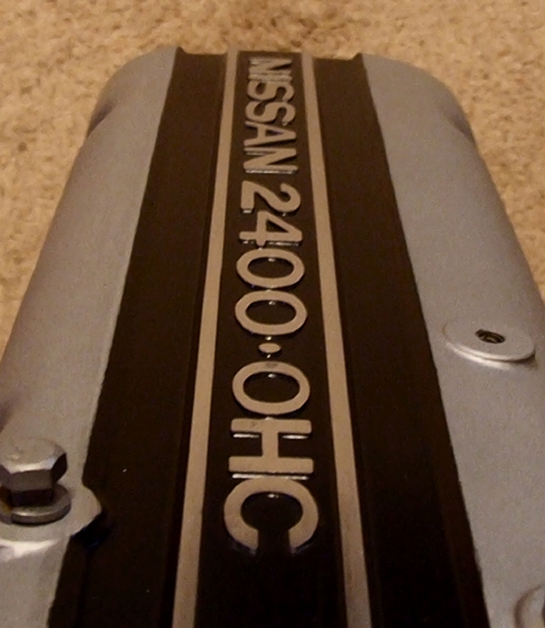

I've done a dozen of them in the last several years (see the pictures in my gallery for samples). I find it easiest to just rub a light coat of wax on the high ribs and letters, then paint the whole thing. Then I come back with sandpaper and a narrow block of wood to sand off the paint and at the same time bring the high metal surfaces to a nice bright shine. You can develop any shine on it up to a very polished look depending on where you stop with grades of sandpaper. Generally I then spray the whole cover with a topcoat of high temp clear (gloss or matte - I prefer matte).
Here's a few samples & lots more pix in the gallery.
